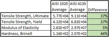

    4130 chromoly tubing is stronger, stiffer and harder than DOM tubing. There are a few properties of the materials we will compare to show the stronger material and why it matters. Ultimate strength is how much force is required for the part to fail. Yield strength is how much force is required for the part to deform permanently. Modulus of Elasticity is the material’s resistance to being deformed elastically (not permanent), a higher elastic modulus is a stiffer material. Brinell hardness is how hard the material is to indent. Using mechanical properties from online sources of AISI 4130(chromoly) and AISI 1020 (DOM), we have broken down the comparison to make it easier to understand using the table below.
    As you can see from the table above, chromoly is overall a stronger choice. The ultimate strength of chromoly is 34% greater than DOM while the yield strength of chromoly is 28% stronger than DOM. This means chromoly can support 28% more force than DOM before permanently deforming. It also takes 34% more force before chromoly fails when compared to DOM. The elastic modulus of chromoly is 7% higher than DOM, giving chromoly a 7% increase in resistance to being deformed elastically. Lastly, chromoly is 44% more resistant to indentation compared to DOM. With the difference in strength, stiffness, and hardness when compared to DOM, and only about a 6.5% increase in total cost for chromoly, it is obvious to us at SDHQ which material is better suited for the strongest bolt on design available.
    We never designed our sliders to simply save weight or for looks. From the beginning, our goal was to create the best slider on the market. The weight savings was a bonus after carefully engineering our design and material choices. There are several points of strength we implemented in our design. Our sliders are supported front to rear, leaving no unsupported dead tubes. The front mounting point on our sliders mounts directly to the vehicle’s body mount. This location was decided for two reasons, it is a very strong part of the frame, and it is the closest available mounting location to the front tire. With this mounting point so far forward, the main slider tube is well supported at the front tube union(where our outer tube meets the main tube). Our front mount is boxed to maximize and reinforce the strength of the body mount as well as the slider. The middle and rear mounts use a similar mounting design to the front.We utilize existing holes in the frame to bolt through and into our CNC machined reinforcements. The mounts also wrap around the bottom of the frame and attach to the inner lip where the frame is double plated and welded from the factory. The rear mount is at the very rear of the slider and extends farther to the rear as well upward, extending this mount creates a triangulated mounting point designed for optimal strength. At SDHQ, we have always strived to deliver a top quality product even if it means we are not the least expensive option available, we know not a single corner was cut, and we are giving the customer the strongest and lightest slider on the market.

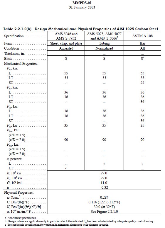

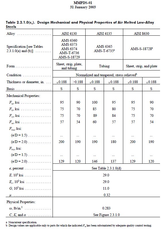

    Can you provide source of your values? Unreferenced table you gave doesn't do the world much good if you are calling someone out on giving false data. We certainly don't know what alloy and spec and heat treat you are using or comparing. (That table you have shown has Ftu shown to a decimal place... come on really?)
    Note, I own stock in neither of these companies.
    Here is a GUESS of what materials the vendors MAY be using for comparison. I am referencing MMPDS-01 (same as Mil-hbdk-5j) because it is pretty easy for anybody to look up and contains the publicly reported metallic material properties accepted by the FAA for compliance with the Federal Aviation Regulations.
    Modulus E for 'S' basis materials is 'typical', unlike the strength data given for most materials which will usually be specification minimums or statistical minimums.
    per Table 2.2.1.0(b) 1025 Carbon Steel N tubing has E=29.0E6 psi
    per Table 2.3.1.0(c1) 4130 N tubing has E=29.0E6 psi

    Here is the above info written again, the modified chart since you were not a fan of our decimal use, and our reference data.
    Chromoly is overall a stronger choice and represented a $53.20 price increase over DOM for us. The ultimate strength of chromoly is 34% greater than DOM while the yield strength of chromoly is 28% stronger than DOM. This means chromoly can support 28% more force than DOM before permanently deforming. It also takes 34% more force before chromoly fails when compared to DOM. The elastic modulus of chromoly is 7% higher than DOM, giving chromoly a 7% increase in resistance to being deformed elastically. Lastly, chromoly is 44% more resistant to indentation compared to DOM. With the difference in strength, stiffness, and hardness when compared to DOM, and only about a 6.5% increase in total cost for chromoly, it is obvious to us at SDHQ which material is better suited for the strongest bolt on design available.

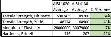

    Below is an updated comparsion using the refrence you posted above -
    Recalculated with 3rd reference; MMPDS-01
