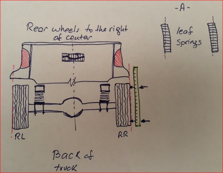

    Here is the story.
    Have bought my Taco Off Road 2017 on the last Sunday of October. A week later I have had the original rims replaced with different rims from Discount Tires but kept the tires. The wheels were done in the night time and went home. The next day I looked at the new rims/wheels how they look and to my surprise the RR wheel is sticking out about 1/2 inch more compared to the RL wheel. Have took a 3ft ruler and put it against the tire to check it out and yes, the RR is more to the right compared to the RL.
    Jumped in the truck, went to the D.T. place, dragged the sales guy out and showed him the difference in tire position compared to the rear fenders. He confirmed the issue and took the truck on the lift and swapped the rear tires. Same problem, this proves the rims are even and do not have a defect. From there I went to the Toyota dealer to find out why my truck is like this? My dealer (very nice and helpful guy) was busy but allowed me to check out the other Tacoma trucks in the lot. Grabbed another guy from the dealership and we checked all brand new 22 Tacomas at the dealership from the PRO to the base one and all have the same issue with the rear axle being skewed to the right. By that time my dealer guy showed up and we checked again. At this time we are 5 guys looking and talking about the problem when from the back a guy with his wife stopped, listened and made the comment that his 2016 Sport had the same problem but after the replaced the rear leaf springs (doing a lift) the problem got fixed, the wheels are even now compared to the fenders. A friend of mine that is an auto mechanic mentioned that from time to time he have seen this problem with guys doing DIY lifts and leaf spring swaps when the leafs are installed wrong.
    I would like to know if anybody has the same problem with the Taco (without any modifications or upgrades) and also if the problem is still present after the rear leaf springs have been replaced. Looks like there is a problem with the OEM Taco leaf springs not being equal in thickness or installed wrong (see A). Best way to find out is to take a ruler and put it against the tire and see where it lands on the fender.
    Let us know please.

    Bed/frame shifted after 1 week of driving like an old lady? If my U bolts are the problem, what about all the other Tacos at the dealer with the same problem?
    Can you check your Taco 16-17 and see if you have the same problem?
    P.S. I get the finger from the Rascals passing me...

    Can you guys please check your Tacos and see if the problem is wide spread? Would like to know why and find a solution. Other than that, the truck runs perfect, no tranny problems and very solid. Is just a visual pain.

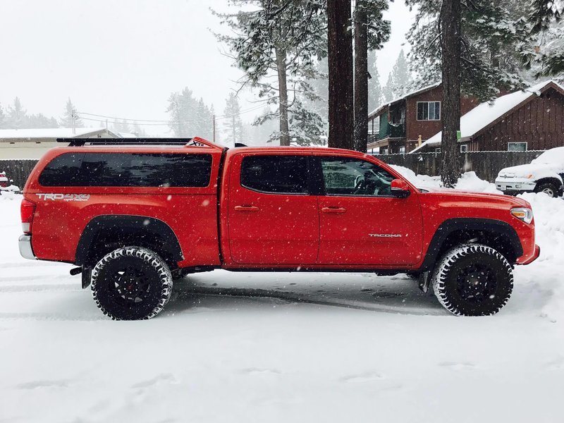

    I have a 16' DCORLB and mine had the same issue. I recently installed Dakars and an Icon stage 7 and the problem seemed to go away. Well, either t went away or the lift made up the difference on the lower side. This seems to be a normal thing. Btw I love the ARB Dakar springs. They will add about 2.75" of lift. Here is a picture of the Dakar springs sitting wth shocks at stock height in back wth 265/70/17 tires.
