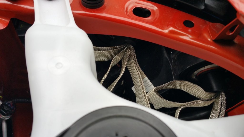

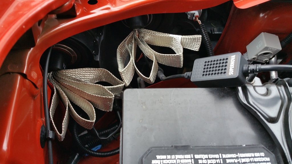

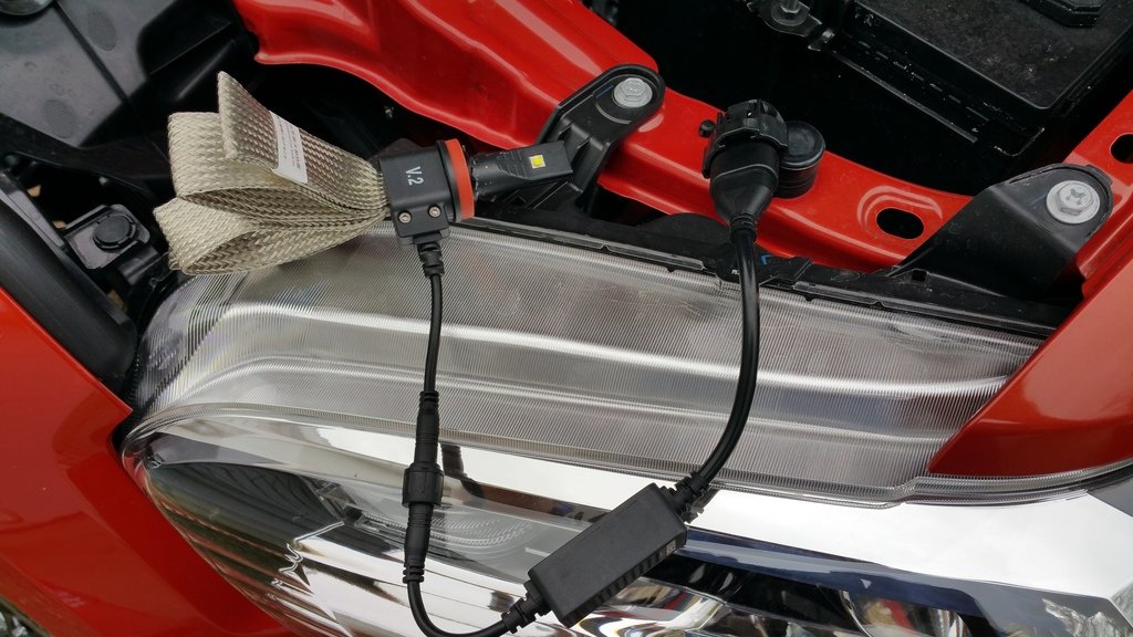

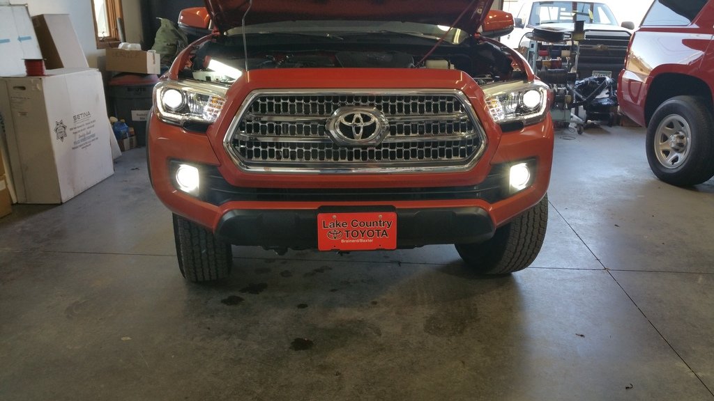

    Here are the pics from my install
    Don't forget to tighten down the nut from the factory h11 plug to the power supply, the one you forget is the one on the fog light, its way down there.
    I spread the heat sync material out, it is flexible and makes it easy to get around the passenger side, no fan on this brand.
    The fogs are the challenge you have to reach down from the top and helps if you have long skinny arms like myself.
