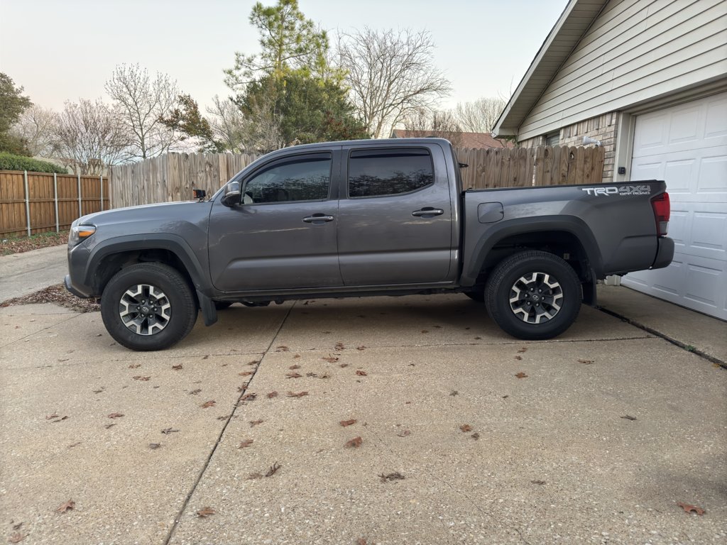

    What's the confusion? The post started by asking for light truck tire suggestions, but really light truck tires are the B/C/D/E/F load range tires that are meant for heavy duty work. Michelins have LT in the name, but you just aren't in need of LT versions.
    Non-LT tires consist of P-metric (with the P) and metric (no P). Both styles of metric tires (P and non-P) offer SL and XL ratings for many of the sizes. Michelin Defenders in the 265/70R16 size are a non-P (just standard metric aka euro-metric), and they are XL rated. They will ride like any other nice riding non-LT tire.
    XL just means they have a tiny bit stronger sidewall for the ability to carry a bit more load. Michelin has decided to make pretty much every non-LT version of the Defender LTX M/S2 in XL. I am not aware of any in SL. The result is a bit more carrying capacity, and they are a bit stiffer for cornering such. I find mine to be really nice tires. They are not harsh at all, but they handle well.
    I have the 265/70R16 XLs.
