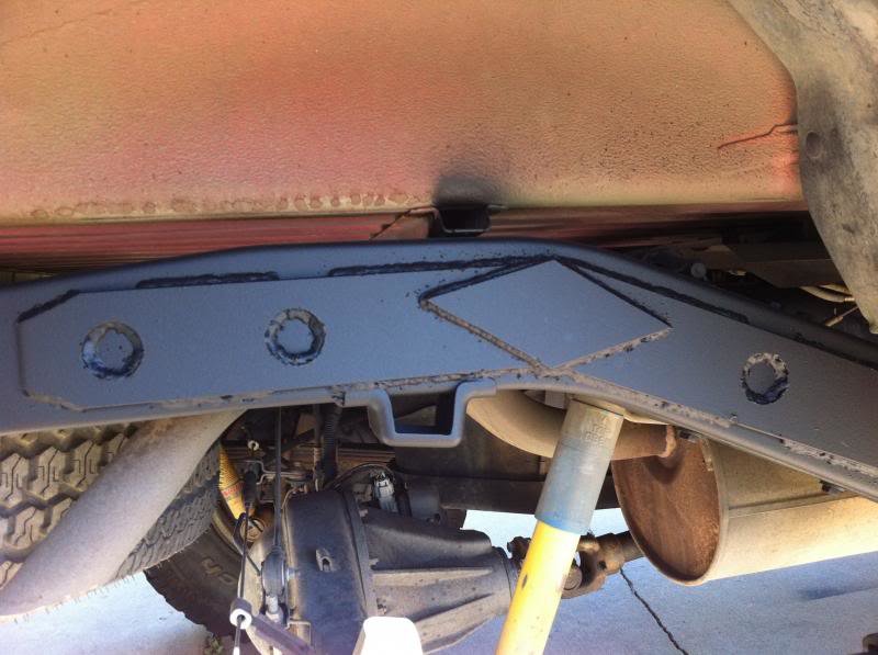

    45acp and I got my plate from a scrap yard. Paid like $8 or something for enough metal for both sides

    How do the side plates like the ones pictured compare to the boxed frame kits I have seen around?
    BTW that plate looks nice!

    I'd imagine quite well.
    A lot of guys who carry a lot of weight in the rear (armor, RTT, etc) use the outer plate method (or whatever it's called)

    3/16" plate is plenty for frame plating or boxing. It's thicker than the stock frame. Boxing the frame will be stronger than outer frame plates, but either will work and help to keep your frame from bending after the addition of weight over the rear of the truck.
    As for which ones are best? Not a whole lot of difference in the plates themselves. It will come down more to the quality of your welds.
    One suggestion I'll make with outer plates. If you don't fully weld around the perimeter (like the ones Madjik_man posted) I think it's a good idea to use some seam sealer in the areas around the edge where there isn't a weld. That will help to keep moisture out from between the plates and the frame. Otherwise you can develop rust between the plate and frame which will eat through the frame quicker than if you didn't have plates at all.

    I was thinking the same thing looking at that picture.

    Already ran a bead of silicone adhesive around the non-welded areas. Should hold up fine IMO :notsure:

    Silicone will be fine but it attracts dirt and the dirt sticks to it. It washes off fine, but just looks dirty most of the time. Seam sealer is stronger and doesn't attract dirt.

    Why don't I confer with you before I do anything? :(
    I suppose I can dig this sealant off and get seam sealer, I suppose. Do they make it in black? :eek:
