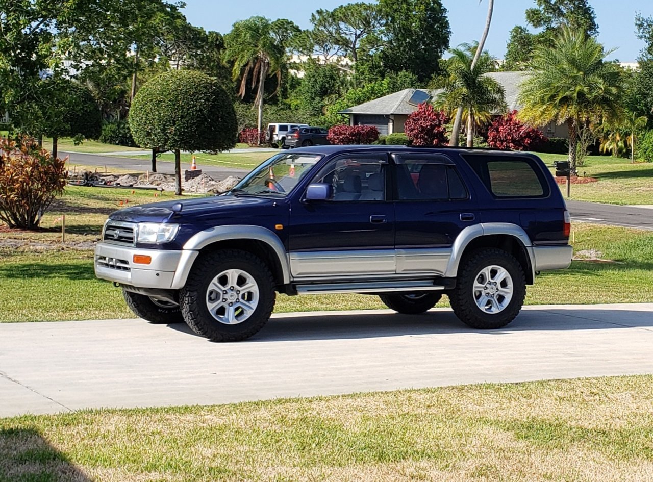

    I have a 1996 Hilux Surf 3.0l TD with 130k kilometers on it. Runs like a champ. I have a gentleman about 15 miles away from me in Florida that has several for sale right now. It is a blast to drive and gets lots of double takes from people.
