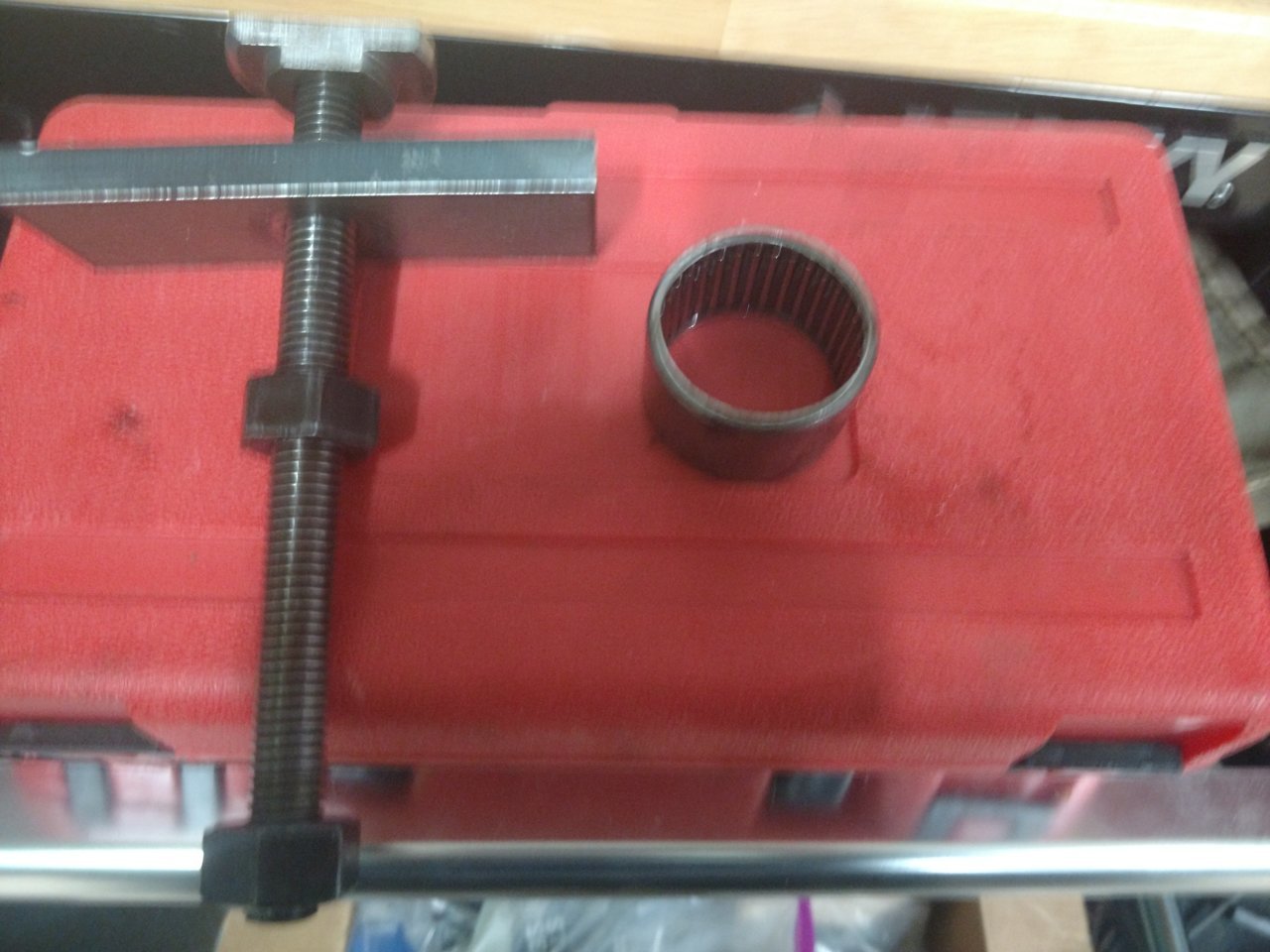

    Just did this Friday, wasn't difficult.... Here is a good video to watch beforehand... https://youtu.be/m9W31KGy6k0
    I also chamfered the piece of the tool that is inserted behind needle bearing, made it easier to get into place. ***note***Ignore the orientation of the t-nut in the picture, it should be flipped around so the non-chamfered edges contact the needle bearing that is being removed.
