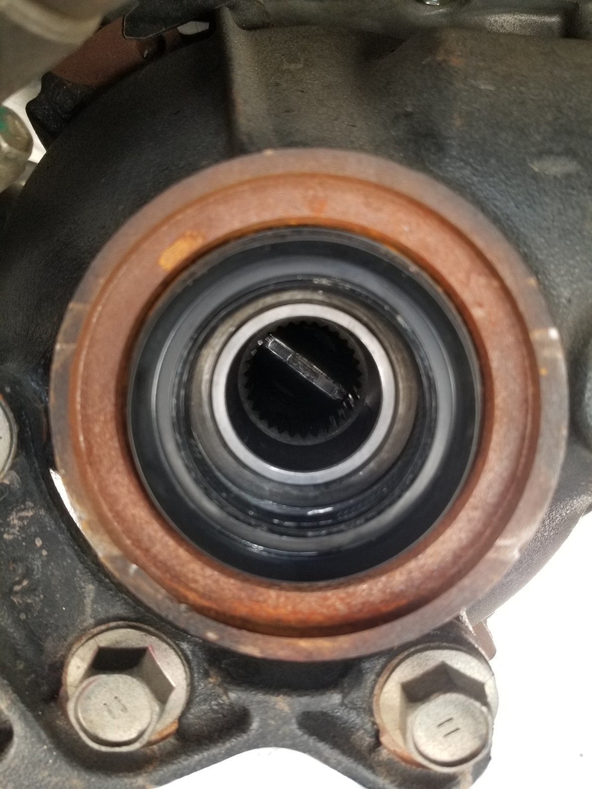

    Can you guys help me understand the concept of this replacement? Does this bushing have a flat surface on the ID as opposed to the geared or ribbed of the OEM needle bearing? Isnt that what the geared end of the CV axel grips and allow the 4WD to apply torque to the axle/wheel?

    Its a two piece bushing sleeve right behind the driver's side axle shaft oil seal that the axle slides through and supports the shaft of the axle, the splines on the end of the axle are what engage within the differential and are not affected by this at all. The needle bearing is a little bit on the fragile side, and does not take the possible side load pressure a lifted Toyota might exert very well. Some people have never had a problem with the needle bearing, but its a weak link. If you aren't lifted, its less likely to ever be an issue.

    I replaced mine as preventative maintenance when I did the wheel bearing and I don't have a lifted truck. The OEM needle bearing, I'm sure has far less than 50% contact with the CV surface because there is a divider between each roller needle. The ECGS bushing surface is smooth so the contact patch with the CV surface is more like 100%. I think it's worth the extra time to replace it if you need to replace the wheel bearing or CV axle.

    the needle bearing is a bearing
    Needle bearings are weak
    You replace it with a better bearing
    The CV spins on a bearing

    It works just as you said. Excepted the "geared" end rides in the spider gear, not the bushing.
    The smooth section of the CV rides in the bushing.
    The link below will tell (show) you all you need to know.

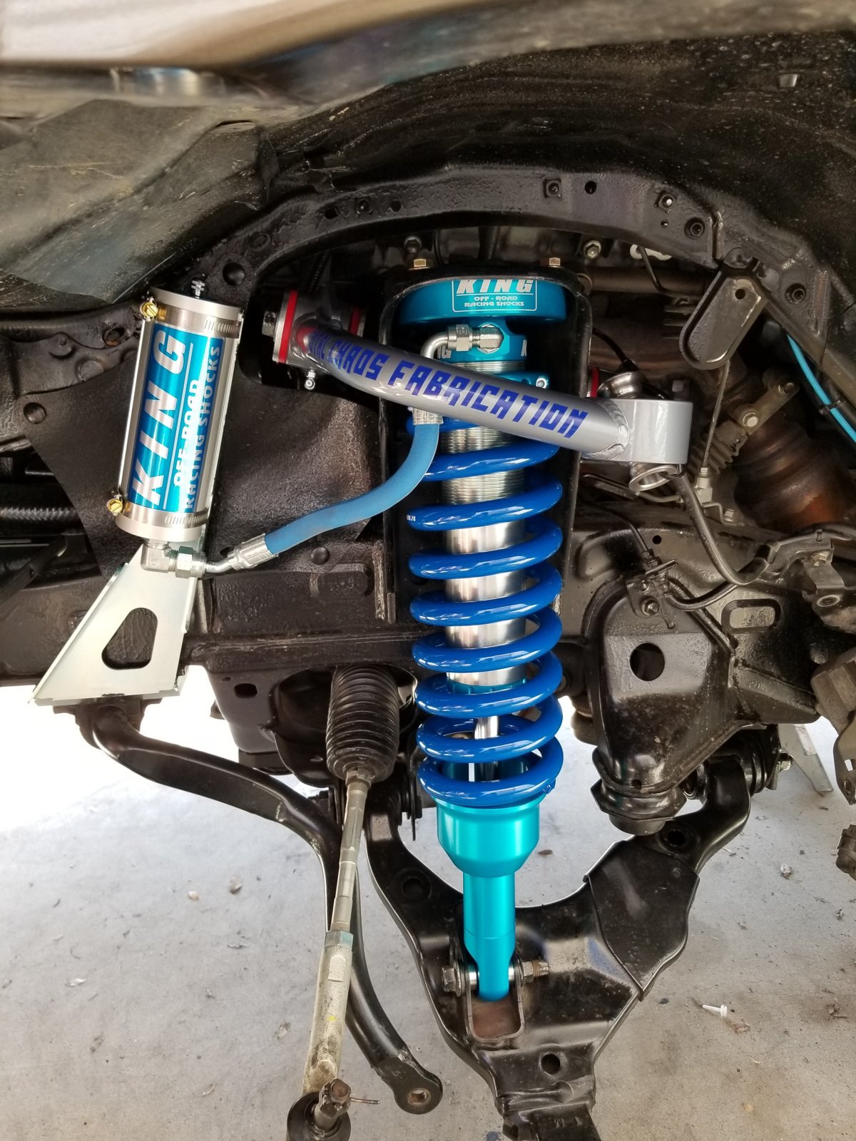

    Me.
    Got 30K on the ECG bushing now, no problems.
    Good luck with your truck.
