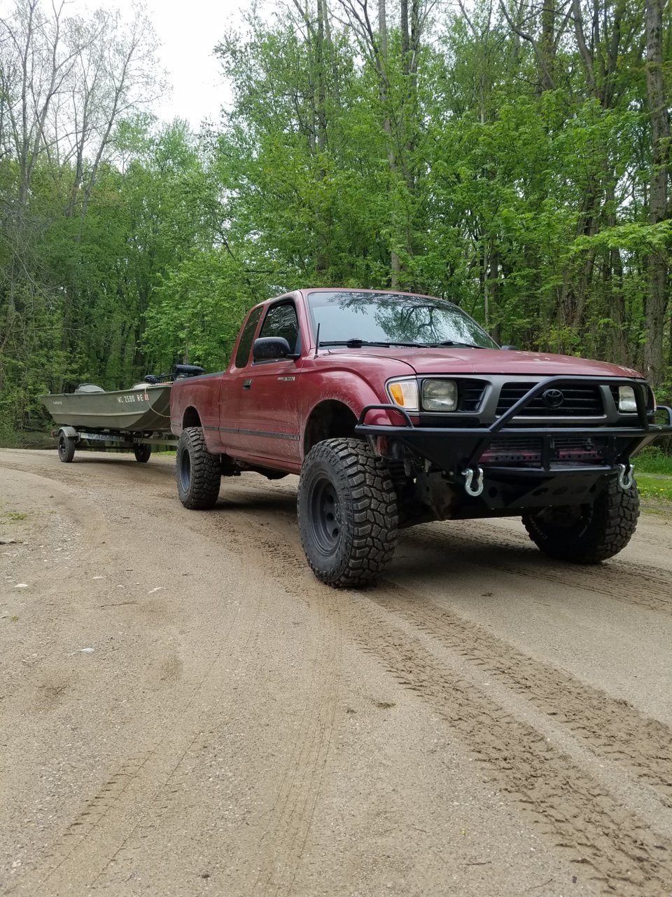

    No fender flares here :cool:20190518_172608.jpg

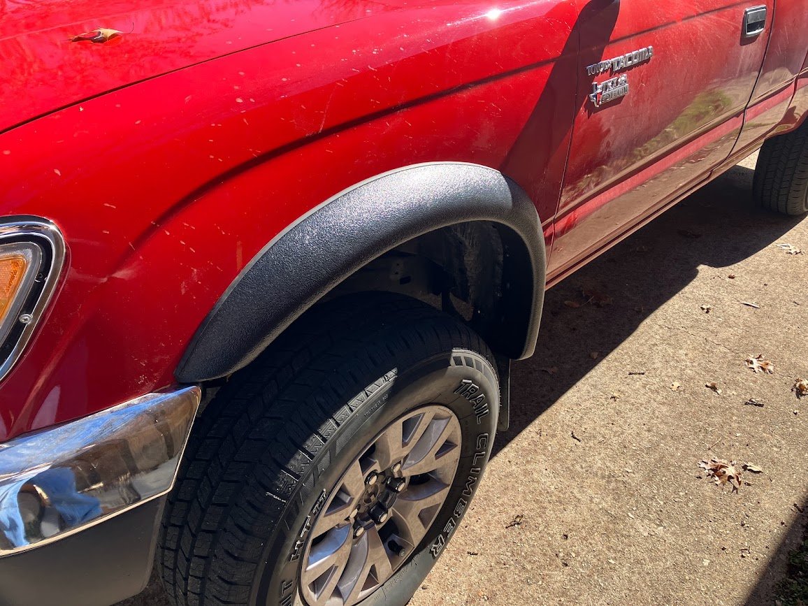

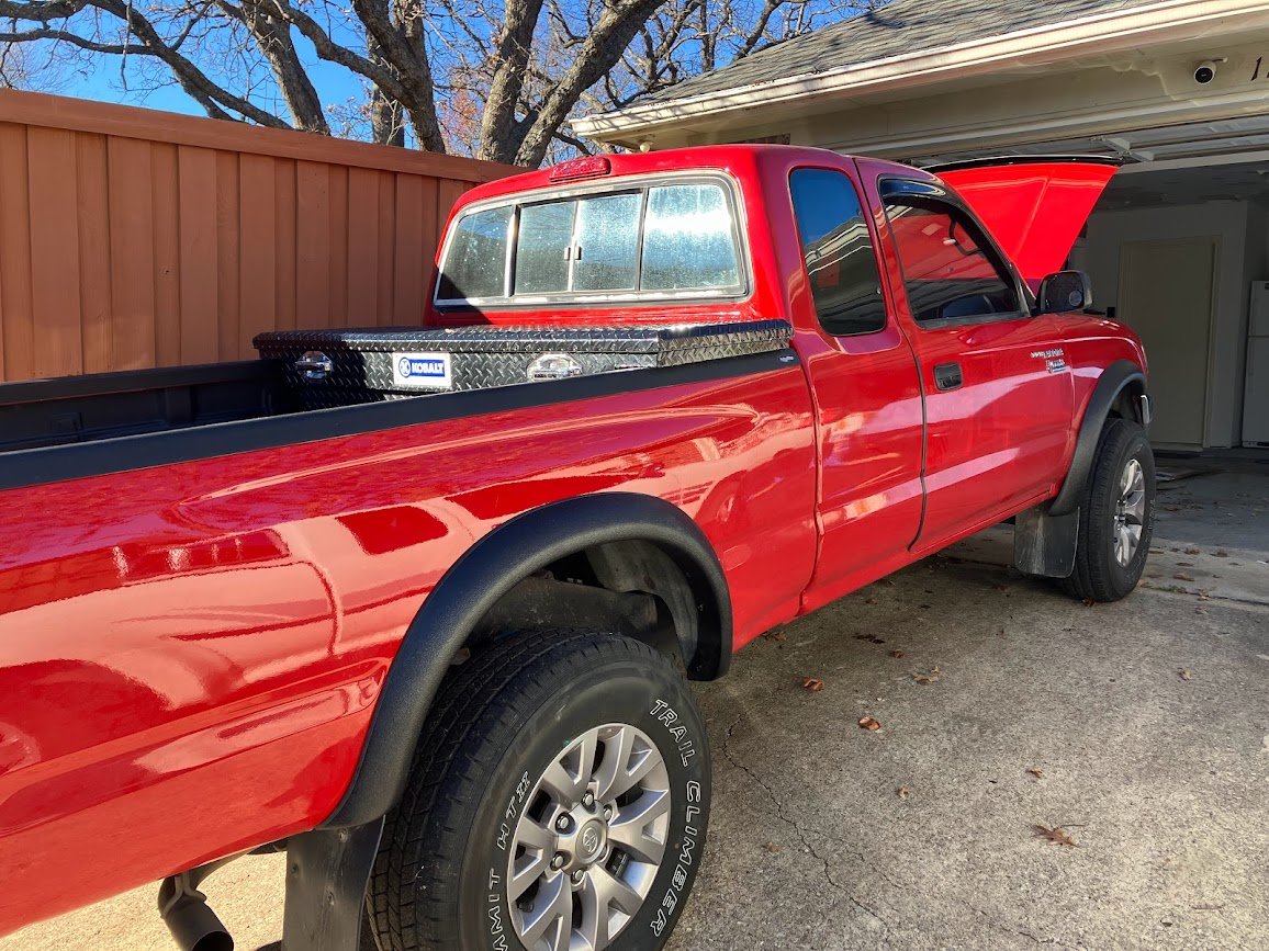

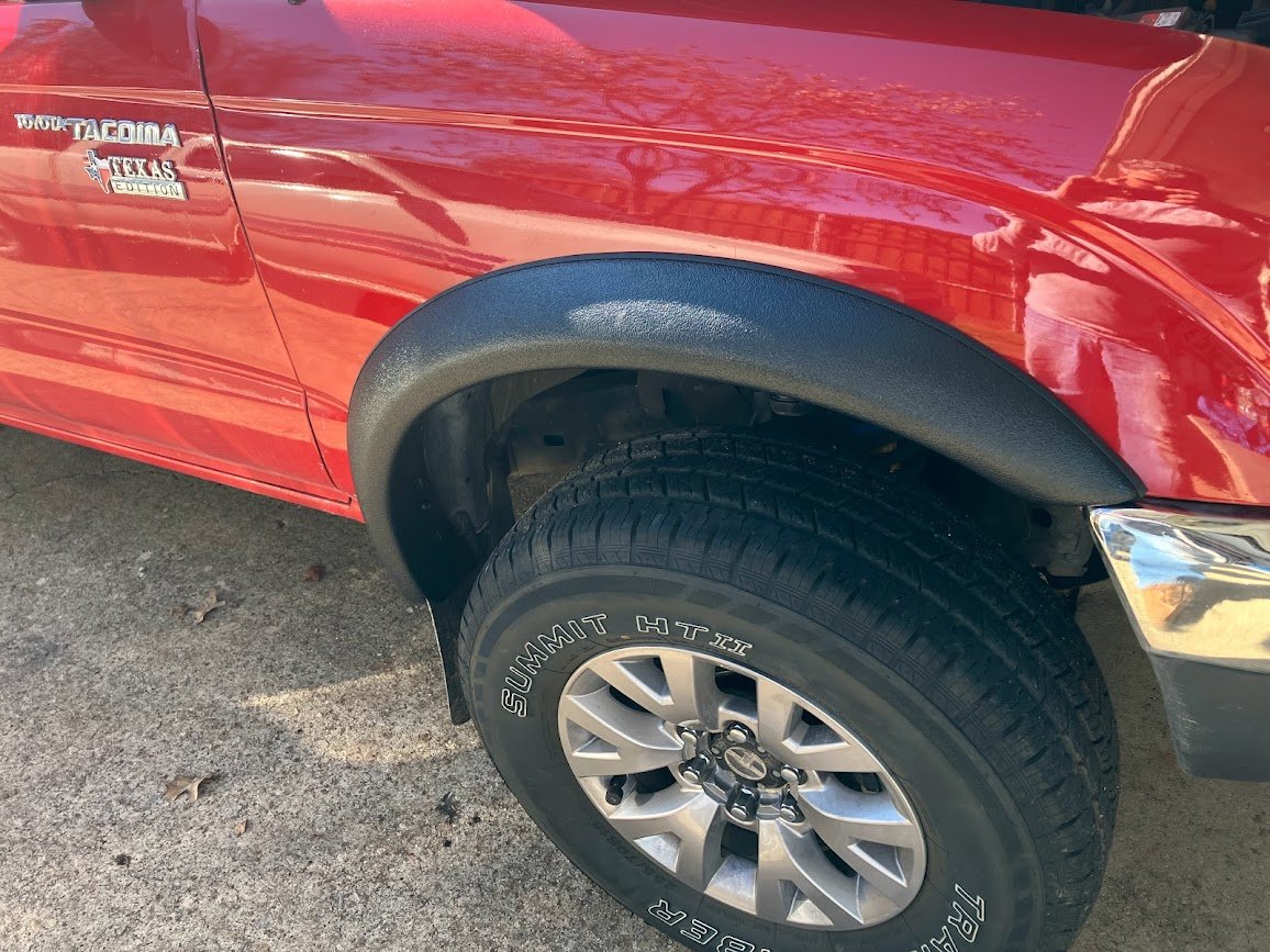

    Chiming in on an old thread but I just installed the PSI fender flares to protect the fenders from rocks and road splash. This was especially important to me after installing the 1" wheel spacers all around (to clear the ADDCO rear sway bar that was encroaching on my 255/70/16 rear sidewall).
    I thought it would be good to also post here for any folks that search on fender flares.

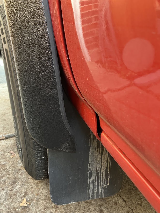

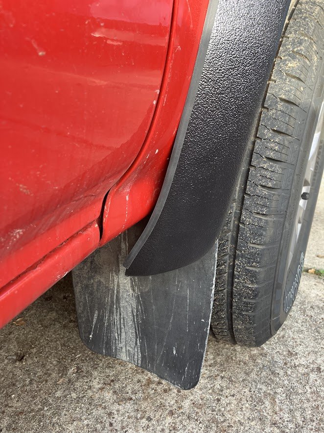

    The front pieces of this kit did not form to the body at the rear and at the lower end and look terrible. Big gap down there. Will leave it for now and figure something out later on. A couple of screws on each side had to be drilled because they did not line up with any of the OEM holes.
    I used a dremel cutting wheel to cut the lower rear edge so that it would slide over the OE mud flaps.
    The rear pieces, OTOH, went really smoothly and lined up pretty well with the OEM plastic plugs.
    The seller is here:
    https://www.ebay.com/itm/254179977236
    I left him neutral feedback since the rear flares install was plug-n-play easy but unloaded on him about the front terrible fitment. He responded that maybe I didn't have a 4WD or that I had different fenders. I indeed have a 4WD and my fenders match up to the body curves of the doors and lower rocker panels.
