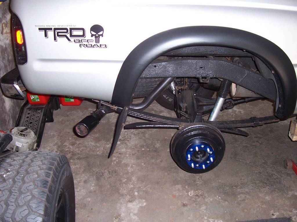

    WOW! Now that is a good deal!!! It was a case of 12. Just finished yesterday.
