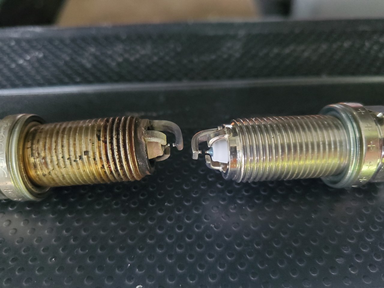

    Yes.
    pickup truck
    Spark plugs are plated. There's no steel touching Al.
    80k miles
