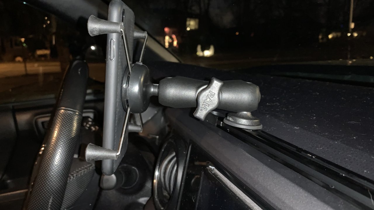

    Anyone using them and more specifically. Which model to securing it did you choose? Does the window suction cups actually stay on in offroad situations? Thanks ram phone mount.jpg

    I replaced the lower bolt on the driver side door grab handle (on the A pillar) with one of the knobs and mount it there. I think I had to get a different bolt than what came with the RAM mount, pretty sure the RAM was SAE. It's been about 10 years since I did it and I can't remember :)

    I’ve used suction it works good and mostly stays on. Sometimes if it’s too hot it will fall off but Offroad no issue. I had the grab handle too and really like that. Removed it recently due to adding a boost and AFR gauge so it uses the same place but that’s an awesome location. My only hesitation was it falling out wheeling but never did.

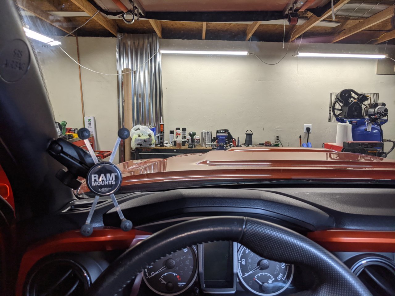

    Not sure if the 1st gen has anywhere to bolt to but worth looking into it. PXL_20201101_224401708.jpg

    Yah, Theres nothing factory their for me to use. But I love the placement and just might bolt one up right there.

    I'd advise you use only existing fasteners or holes in or around the a-pillar structure since it is a critical member for rollover protection. Making new holes could be a bad idea if they are in the wrong place.

    Theres a plastic trim piece over the frame correct? Couldnt I take the piece of trim off and bolt the phone mount down to the trim and then put it back?

    I'm surprised that the '01 doesn't have a handle there. It's handy that the '02 does. The plastic covering of the a-pillar should be strong enough with a little bit of extra support on the backside. If I were in your spot, I'd drill a hole and install a Riv-Nut with a backing washer. Only downside is that you get one shot at it unless you've got a spare plastic a-pillar trim piece kicking around :)

    I suppose you could, might be kind of floppy for anything on a 3"+ arm. Couldn't say for sure.
    I don't think that fits anything besides 2016+.
    OP, if you bolt to the trim, you might want to use a low profile head fastener like an AN525 type head and put it in so the head is under the trim for clearance to the a-pillar, or at least pull the trim and see how much gap you have to work with. Mounting a rivnut or any other threaded fastener to the plastic is not a good idea, it had to grip the plastic and support both installation torque and the weight/bouncing off the mount/phone.
    If the 02 has a grab handle there the 01 might already have brackets there for a handle.

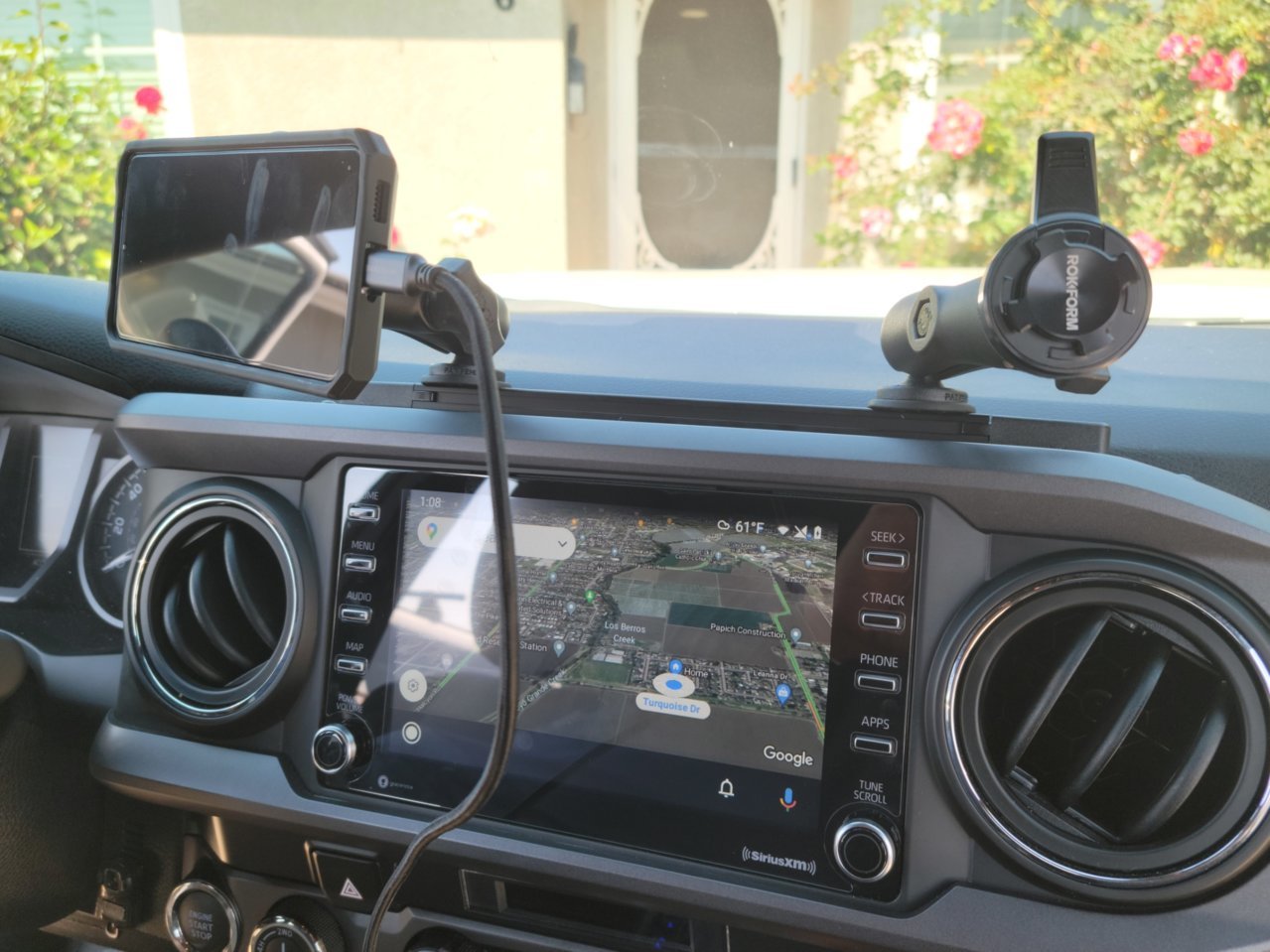

    I recently installed an Expedition Essentials track and RAM mount for my phone. Today I traveled for work on a short 4 hour trip. The phone vibrated badly. I did some adjustments which would help, but only temporarily.
    Anyone have any issues like this?
    If so, what was the solution?

    Shortening the effective lever arm (horizontal distance from base to phone) by adjusting it to be more vertical might help. Or making the channel that the base mounts to more rigid might help.

    I adjusted the arm from horizontal to a slight angle of about 30 degrees. This helped a lot with the vibration however, it created another issue, the phone started bouncing. The track is screwed in there places and bolted into the brackets for the radio. I don’t think it can be tied down any tighter.

    I run the same EE TTM but use a Rokform case and mount on a Ram ball and extension. Get the 3" Ram extension (or shorter) to shorten the lever arm. My S21 with magnetic case and cnc'd Rokform adapter is pretty heavy and with the shorter extension, is really stable. The TTM is way stout so that's not an issue. The X mount looks to really add a lot of length which, obviously, increases the moment significantly. My Rokform mount is heavy but compact so the phone isn't stuck way out beyond the dash.
