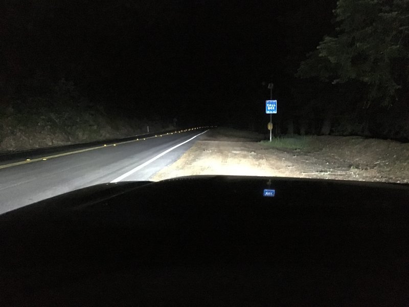

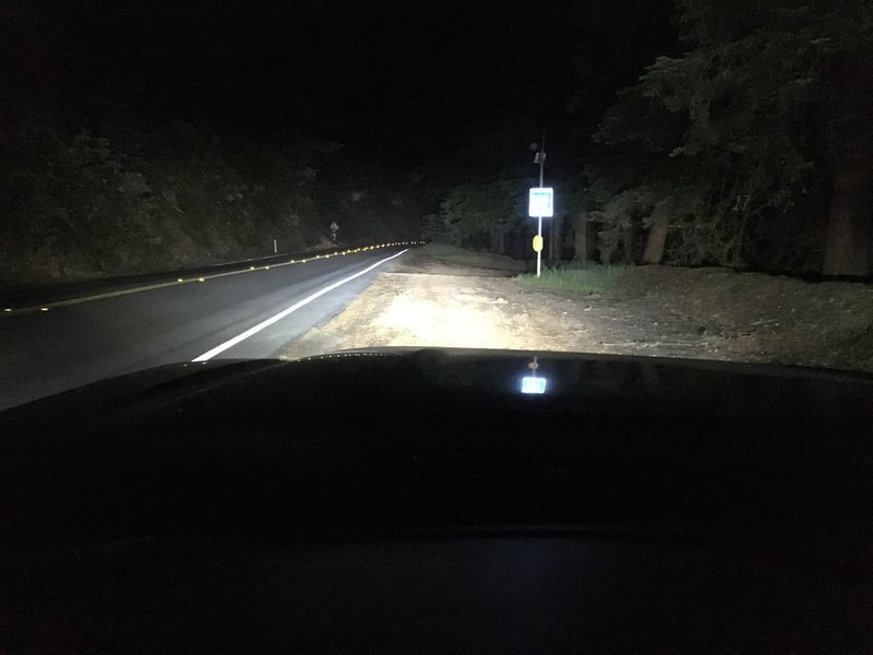

    With these LEDs they are bright and they reach out!
    Lows:
    Lows + fogs: (didn't get a pic but did go through some descent fog and the combo worked great)
    Highs:
    Own the night and get these lights!
    Turns out the GoPro isn't good for capturing the lighting. The curved lens and maybe the focus point didn't work. Luckily I took a bit of video on the iPhone.

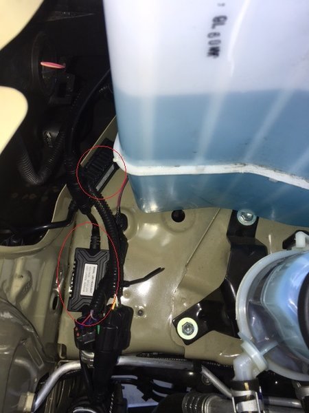

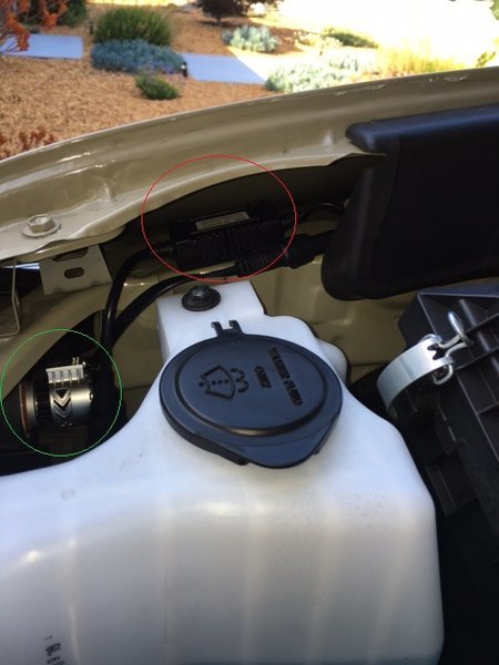

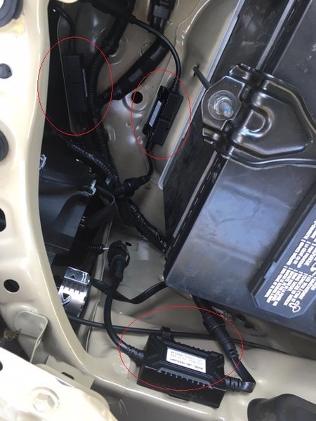

    EXTERIOR: Toytec Boss 2.0 Dakar CS047R Leaf Springs Tailpipe chopped Pelfreybilt Front full hoop front bumper w/ Pelfrey fairlead Pelfreybilt Rear standard bumper Pelfreybilt Aluminum IFS, Mid, Rear (exhaust reroute) & Gas tank skids Pelfreybilt Fuseplate w/ 12 circuit fuse block All-Pro Apex Sliders ProComp 7036 17"x9" -6 offset BFG 275/70R/17 KO2's Warn VR10000-S winch Baja Designs S8 light bar & Squadron sports amber pods in front bumper Baja Designs S2 flush pods in rear bumper Baja Designs Squadron Pro amber pods on Caliraised ditch light brackets @rrentrop reflective black tailgate inserts RSI LED's for regular & high beams Prinsu Cabrac Custom Tradesman Truck Top by Access Manufacturing w/ Powertank 8"propane tank mount & Yakima tracks on the roof INTERIOR: Warrior Products door sill protectors Husky Weather Beater floor mats front & rear Coverking arid multicam seat covers in the front Midland 75-822 CB w/ 4' Firestick antenna on C4 Fabrication tailgate mount Consolevault Hondo Garage iPhone mount
    Here is where I mounted the voltage/canbus boxes using 3M VST.
    Driver's side:
    Passseger side:
    Inside the green circle is the actual unit. As you can see it is a tight fit for the low beam but take a deep breath and don't despair it will fit it just takes a bit of finesse.
  13. May 27, 2016 at 10:15 AM

    These seem very, very bright. The cut-off looks good from the photos, but....have any of the testers felt they are blasting the side mirrors of cars in-front of them too much, like in urban areas?
    I would love to get the lights if I get a new truck, but I don't want to get shot.

    Nobody flashed me when oncoming and didn't seem like they were blasting side mirrors of those in front of me. Tomorrow I'll get my girlfriend to pull up in front of me and I'll take a pic from inside her car.

    From the pics the beams look a little high. Won't know until you put a car in front of the truck.
    I know when I did my HID upgrade the cutoff was much sharper then these, and I had to adjust my beams down to clear the mirrors of the cars in front. Actually had one kid in a lowered Honda civic stop in front of me, let me pass, then got behind me and turned on his high beams on trying to blind me. Poor little civic, his lights didn't even clear my tailgate lol.
    If you have to adjust your beam, please do another test drive and see if there is any jiggle. With mine, the jiggle manifested itself after the adjustment.
