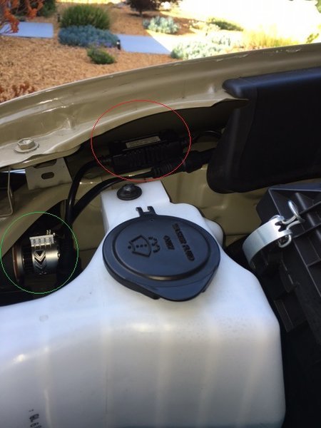

    Check out post #129 on my thread for a pic of how they should be orientated:
    https://www.tacomaworld.com/threads/toynado-quicksand-build.416160/page-7
    It's a matter of putting it in and seeing if it needs to be rotated, and if so by how much and in which direction.
    Yeah it'd be no fun under the hood in extreme heat. Go out at midnight. I did mine at night with a work light clamped in a elevated bike repair stand.

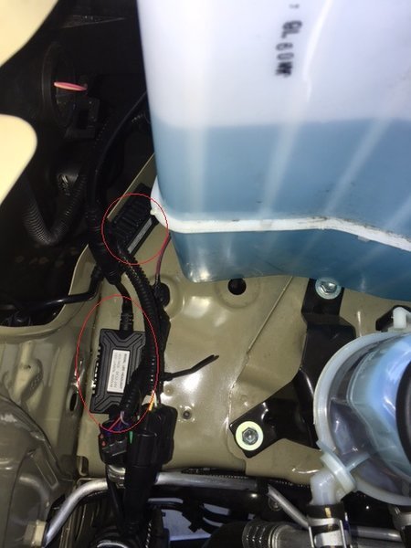

    It was easy. They install just like any standard light. The only issue was figuring out where to mount the canbus.

    Mine are in a similar spot. The passenger side the cables were barely long enough to mount in a flat spot. Have you gotten yours wet at all? That's my only concern is if the canbus gets wet.

    No rain here since the instal. @LovelandTaco is there any concern about the canbus being exposed to water?

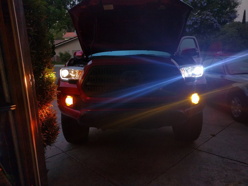

    got mine in tonight. thanks again @LovelandTaco for the Group Buy opportunity and thank you @Toynado for Guineapiggin' them!
    Toynado likes this.

    The kit is fully water proof as well, so no concerns at all with them getting water on them.
