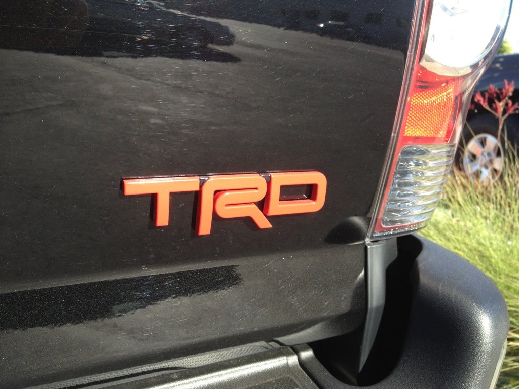

    A few bolts are different.
    If anyone has a moment and wouldn't mind to check a part number for me, I'm wanting the TRD emblem From the tailgate of a Baja Tacoma. Hopefully it wont have some stupid VIN restriction like the wheels do. This is the one i'm wanting the PN for:
    Thank you.

    and the tailgate badge is:
    PT413-35120-02 (Black)
    PT413-35120-03 (Red)
    A VIN is required, but the parts are still on restriction. So it's a no go, even with one... I have tried. Best of luck.

    Was able to order the Baja TRD badge last week. Just a note if you can order it, these are the correct part #'s. VIN # is required. It should be $50.
    PT413-35120-02 (RED)
    PT413-35120-03 (BLACK)

    Why do they restrict parts to certain VINs? If they didn't restrict, they could be making more money.
  16. Apr 15, 2013 at 6:32 PM
    #16
    HIst8ofMIND
    HIst8ofMIND Defend Hawaii
    Jan 25, 2013
    #96081
    1,566
    PJ
    Maui
    2013 MGM DCSB TRD-OR
    Some people had no luck even with the vin. You have to have the corresponding truck. Red baja for the black trd.

    They are special edition parts. No point in paying extra on a special edition anything, if anyone can buy the "special" add-ons and make their own.
    That doesn't mean it's not fun to try and pick up a couple a parts here and there.

    I know someone with a Black Baja so I was able to use their VIN to get the red badge. The dealer just needs the #, they don't care where it comes from.
