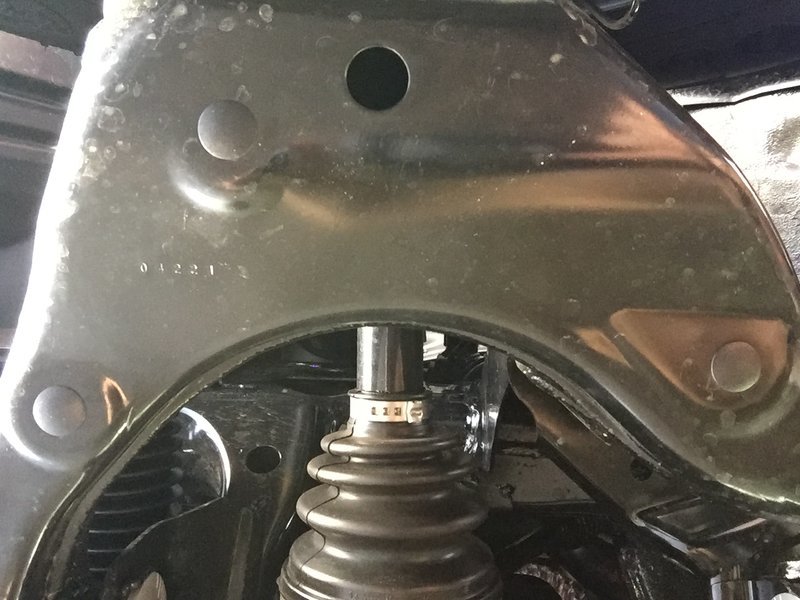

    After enjoying making up excuses to drive my new truck around, I did start to notice 'the howl'. So what every car enthusiast would do, I took to the forums. After some searching and figuring out the correct verbiage, I came across TacoBella's post, headed straight to Lowes and picked me up the two sizes of nylon plugs required to fill the holes in the LCAs (lower control arms). 9/16" & 11/16"
    In a matter of 2.5 minutes, I walked out with a bag of plugs, headed back to the truck, crawled under and installed them on each of the LCAs. Easiest fix to a minor nuisance I have ever come across.

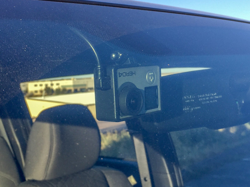

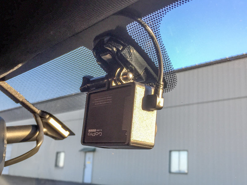

    Next up, I wanted to take advantage of the GoPro mount and be able to record extended time lapse videos. The only problem was that my GoPro's battery would die off relatively quickly depending on the quality of video. With the help of @rsdill2 and his post, I was able to come up with a GoPro hard wire solution.
    I followed his setup exactly, for the most part, except instead of using the supplied 12V accessory car plug, I used a Hardwire Mini USB Right Angle Connector for GoPro kit in addition to the HitCar Add-A-Circuit. This was especially nice because of three reasons: 1) the output voltage(5V) is exactly the voltage required by the GoPro, 2) the cable length is 3.5m, which is more than enough to route wherever desired, and 3) if for any reason the GoPro is still pulling energy when the engine is off, this cable is equipt with a low voltage protection system that will cut the power if the unit measures a voltage supply lower than 11.6V. Now that last one is nice to have, however, it is not entirely necessary and is bonous safety factor for my setup. I wired the cable to the fuse box and into the fuse that powers the windshield wipers, which is only powered when the car is fully on.
    To route the cable, I unmounted the Crawl Control unit, the driver and passenger sun visors, and the front of the headliner, routed the cable above the headliner and down the driver side a-pillar. The only visible part of the cable now is an ~3in section at the GoPro mount on the windshield.
    From inside:
    From the front:

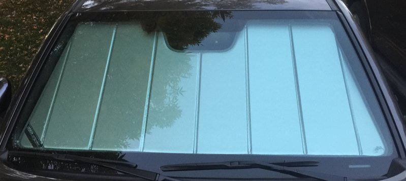

    After some researching and a referral from a friend, I finally decided on a sunshade. The Covercraft UVS100 Sun Shield is a top notch sunshade, if I do say so myself. It's not like the ones made of foil that eventually start falling apart and leave little bits of dust on your dash, seats and floor. This one is thick and fits the windscreen perfectly(about a quarter inch gab on left and right). Couldn't be happier.
    Pretty much a perfect fit:

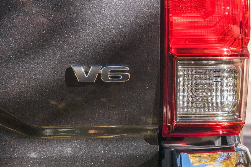

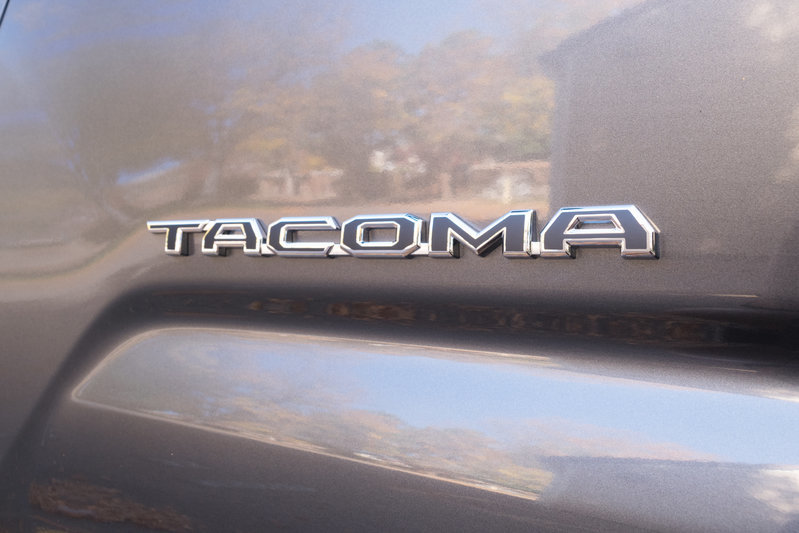

    A couple days ago, I finally hopped on the @rrentrop badge inlay band wagon and boy am I happy I did! Today I got the decals installed and it only took about 35 or so minutes. As long as you follow the supplied directions to a T, they will turn out great.
    If you like the look, pick some up: Badge Decal Inlay Set
    Before:
    After:
    V6 badge:

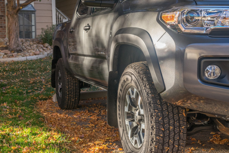

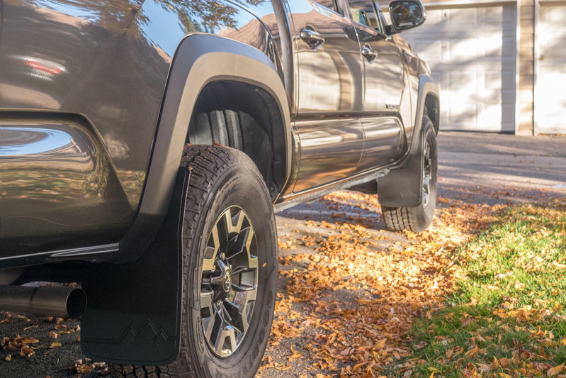

    After getting my badge decals in place, I thought I would quick slap my PlastiColor Mountain Peak Mud Guards (11x19") on.. I was wrong about quick. For some reason it took me a while to figure out exactly how I wanted them to be positioned.
    I started at the back passenger wheel and once I figured out the position, I drilled out three pilot holes(3/16") in the guard that coincided with the three existing screws on the inside of the wheel well and installed. Unfortunately, it didn't look right; the guard was sticking out at a funky angle and I ended up drilling holes two more times. The third times a charm I guess, nailed it.
    After I got the first mud guard installed and looking good, the other three went on relatively quickly. All said and done, it probably took me about 45 minutes to complete. Some people may think that my guards are offset out too much, but I did this on purpose in preparation for when I get new rims and tires.
    From the back:
    From the right:
    From the front:

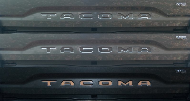

    Tonight I was finally able to inlay the Tailgate Reflective Decal Inserts by rrentrop. Super easy to inlay, as long as you use a liberal amount of soupy water and have a good eye.
    Turned out pretty well. I like how subtle they are until light reflects.
