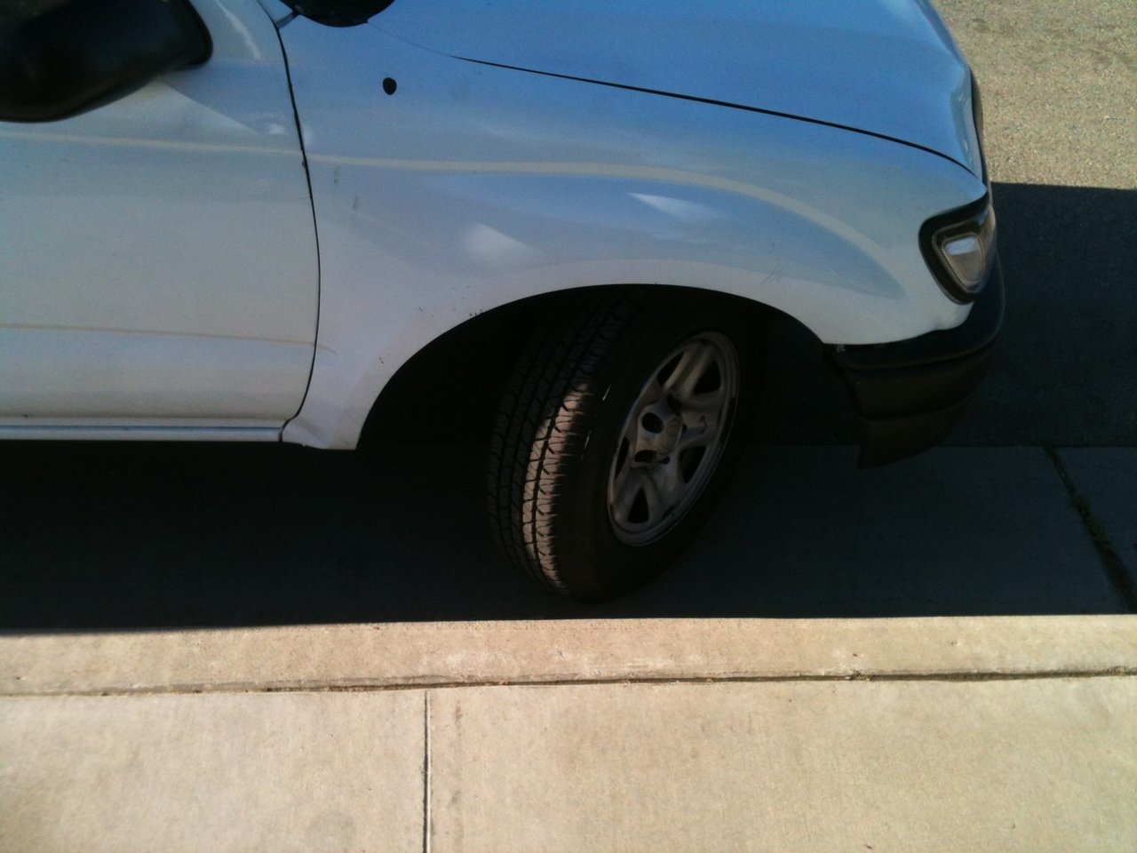

    On my way back home from class, I was slowing down and the whole cab was shaking soo much i pulled over. I got off to the side, kept rolling and it stopped, so I drove for a little while longer till I got home. For some reason i toughed my lug nuts and they were really warm, touched the other side and they were cool. Told my bro about it and to take it for a drive to see himself, and he never made it 1 foot from the curb.1izm87_d7e2ec99f605d7c2b373a8e6cf4251370f1593ee.jpg25oyiz8_6cc9d6fa575f56f0b0d533170545346e4d5d013b.jpg
    Apparently there is a bolt missing now.
