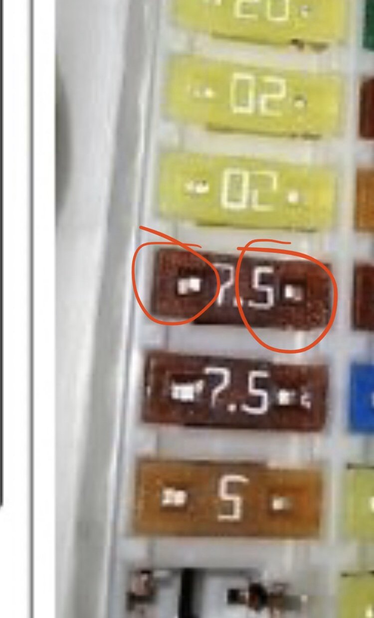

    Probe the top of the fuses with a test light you got a bad one somewhere

    Great idea - I just tested ALL the fuses in the main fuse box under the hood and under the dash on the driver side. Every single one looks good.

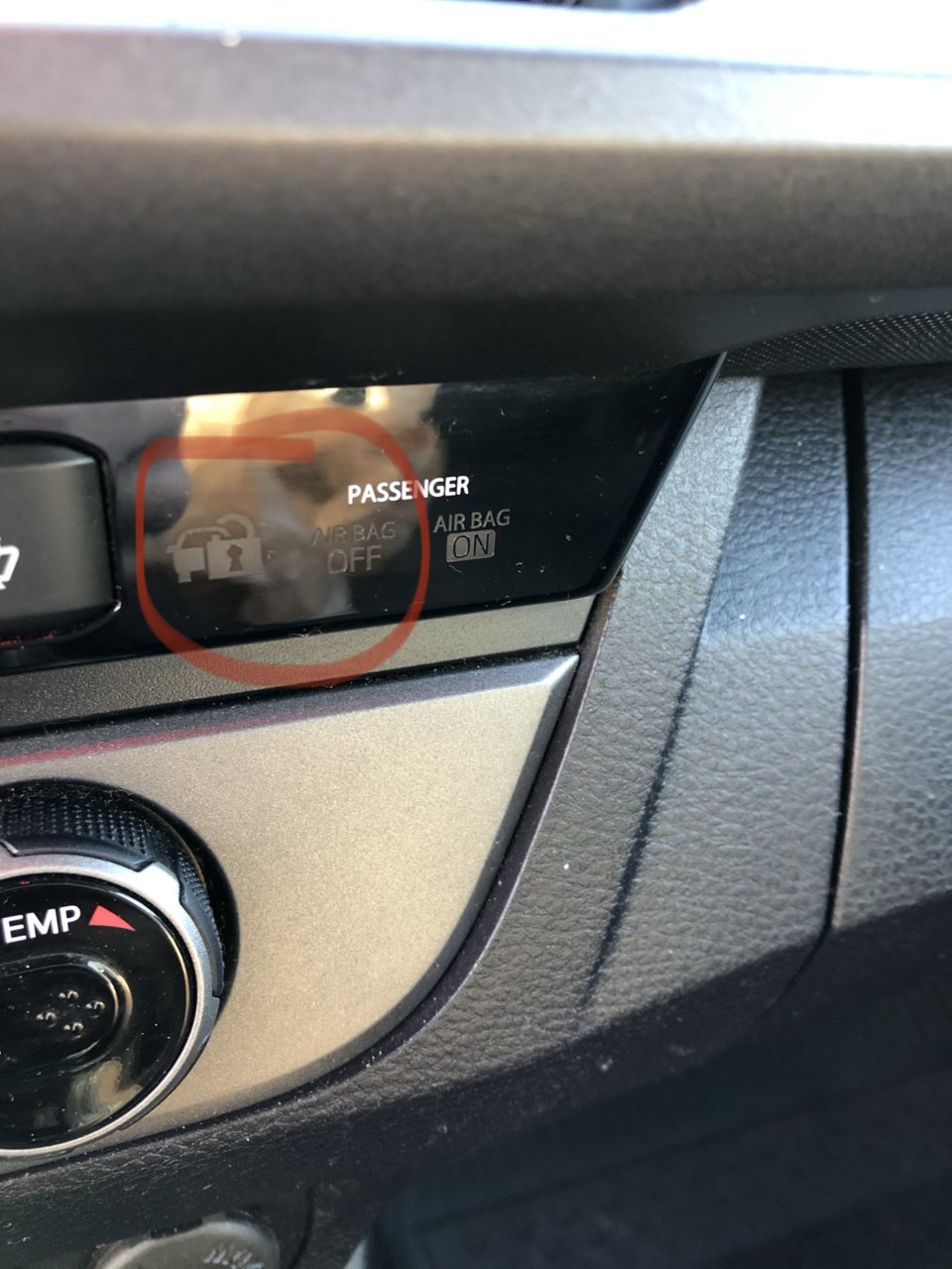

    What’s the security light doing when the ignition is on?

    Nothing - it flashes red when the key is removed from the ignition
    I'm working on getting a video of me trying to start it uploaded - will post soon.

    Did you check the fuses under the hood too ?

    Affirm - I ran my multimeter over every one of them exposed in the fusebox under the hood.
