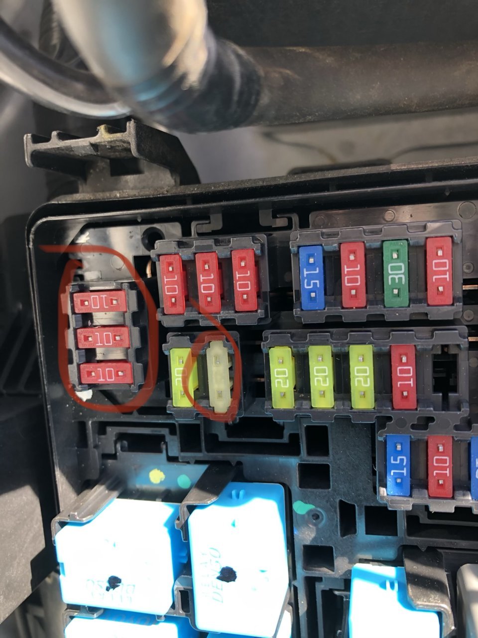

  2. Feb 3, 2020 at 11:20 AM

    auskip07
    auskip07 Well-Known Member
