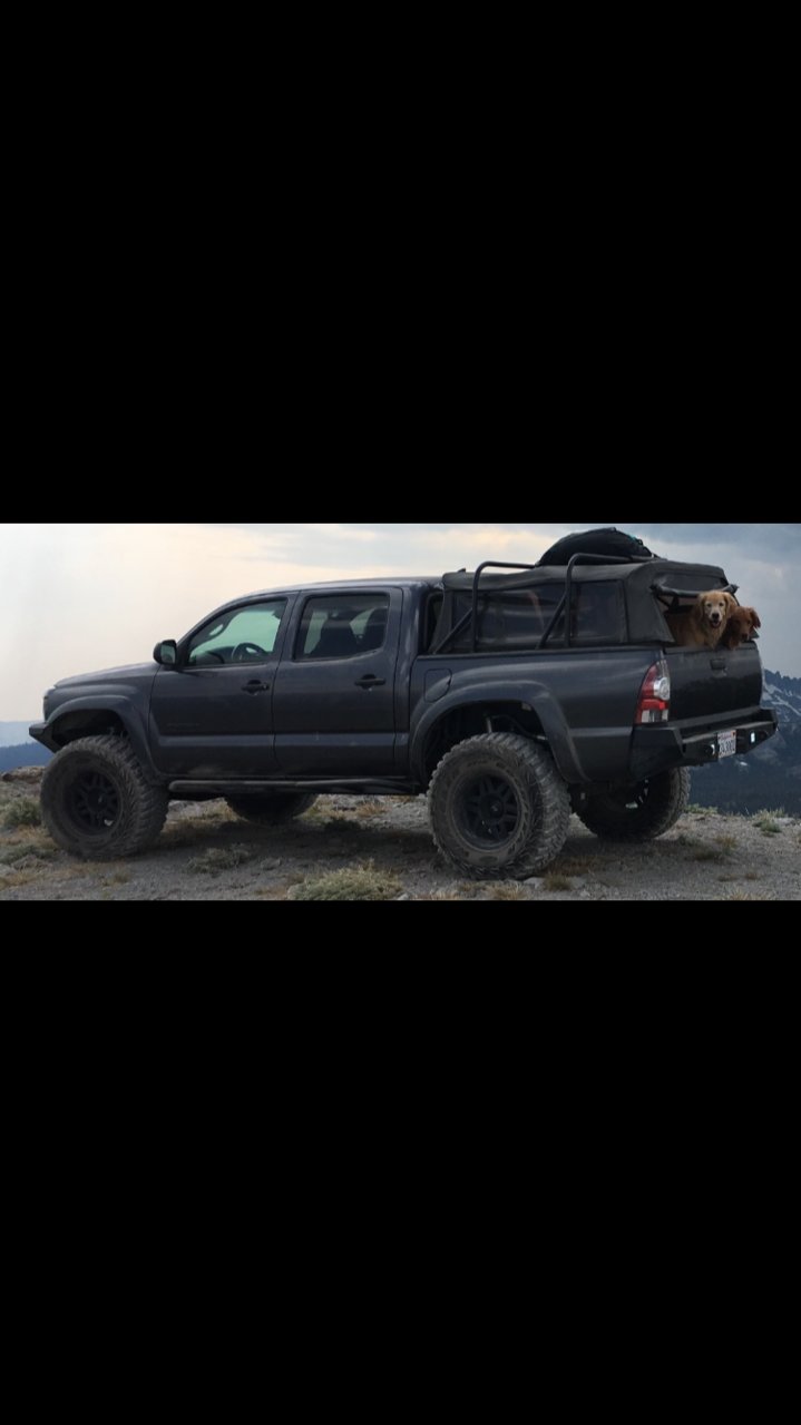

    Thanks guys, awesome work! I was thinking something more like this though: [​IMG]
    Anyone know whose Taco that is? I just found the pic online.

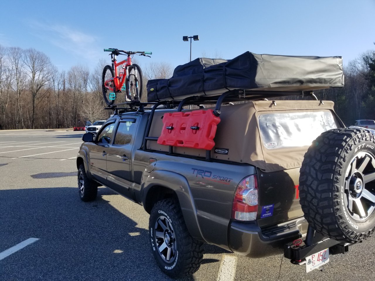

    Mine isn’t a diy I made but Jerry (BAMF) made this one. Fits over my soft topper and clears the cab for surfboards and stuff

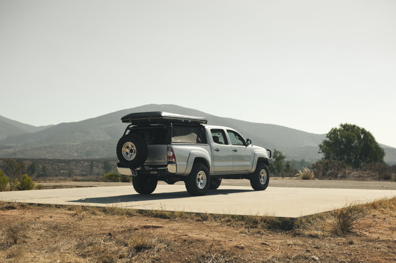

    Here’s the BAMF one Jerry made. I think it’s the only one he’s made. This could give you an idea.

    I had one custom fabbed to host a tent on top.

    Nothing against Mobtown, they do amazing work, but I don't love the looks of this rack (just a personal aesthetic), but do appreciate the versatility of it.
    That's a different style! On a related note, how do you like that Bestop? I debated getting one of those buuuut, having had one on a Jeep for a long, long time, I was a little hesitant. Curious how you like that one.
    Interesting. Can you fold the top up with the rack on? (Obviously you couldn't with the tent on).

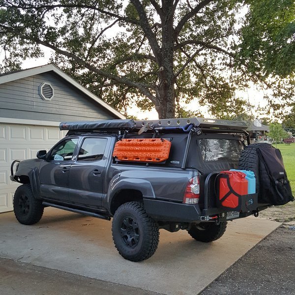

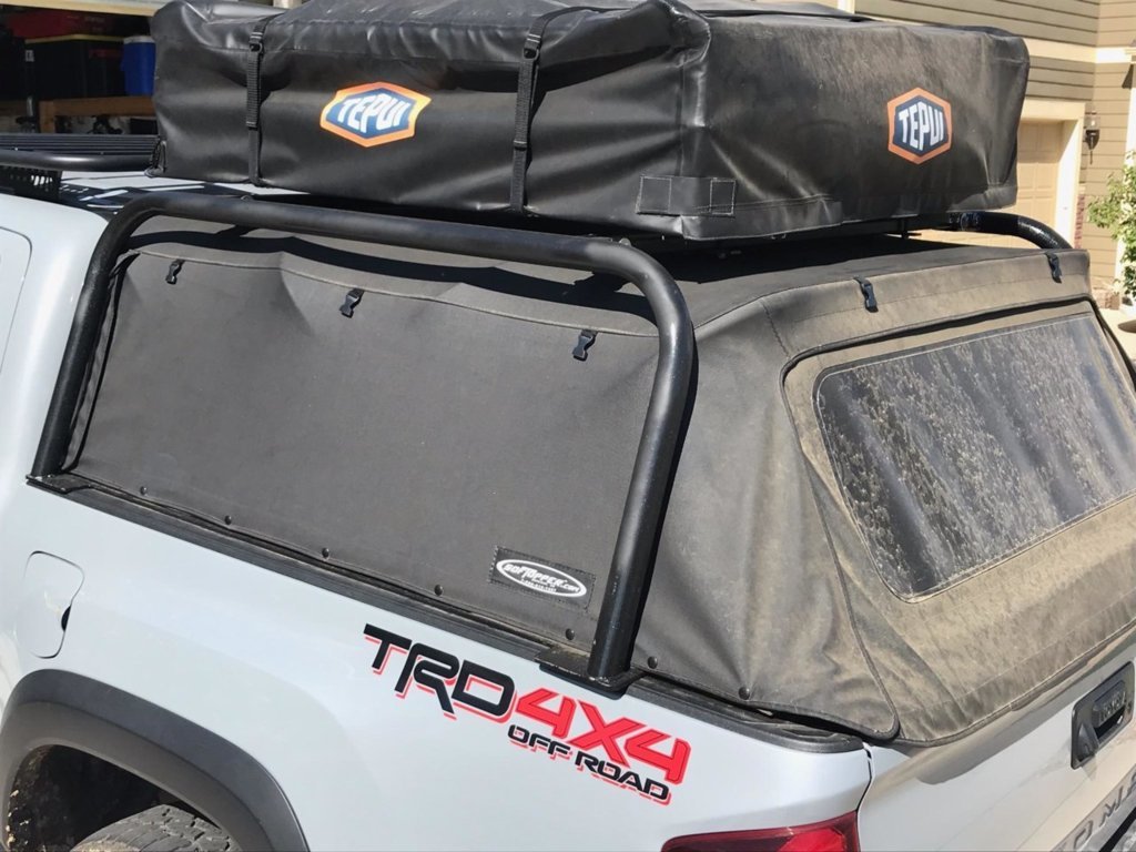

    Whenever a thread comes up, I save a pic, so I've got a dozen or so pics saved but am not good about labeling them so not sure who makes these.
    When I build one, I'm interested in these criteria:
    1). as tight as possible to still allow the topper to fold down
    2). removable crossbars as I load motorcycles and want the option of just removing a crossbar or two and not the entire bed rack. There's a vendor here (that I can't find) that builds one where the crossbars slide/adjust on a laser cut plate. Kinda cool design. I'll try to find the pic
    This one kinda fits the bill for me. Easy to build, too. Just a few of bends in some 2.5 inch tubing
    And I like the looks of this one (but maybe it's all the other cool bolt on goodies)

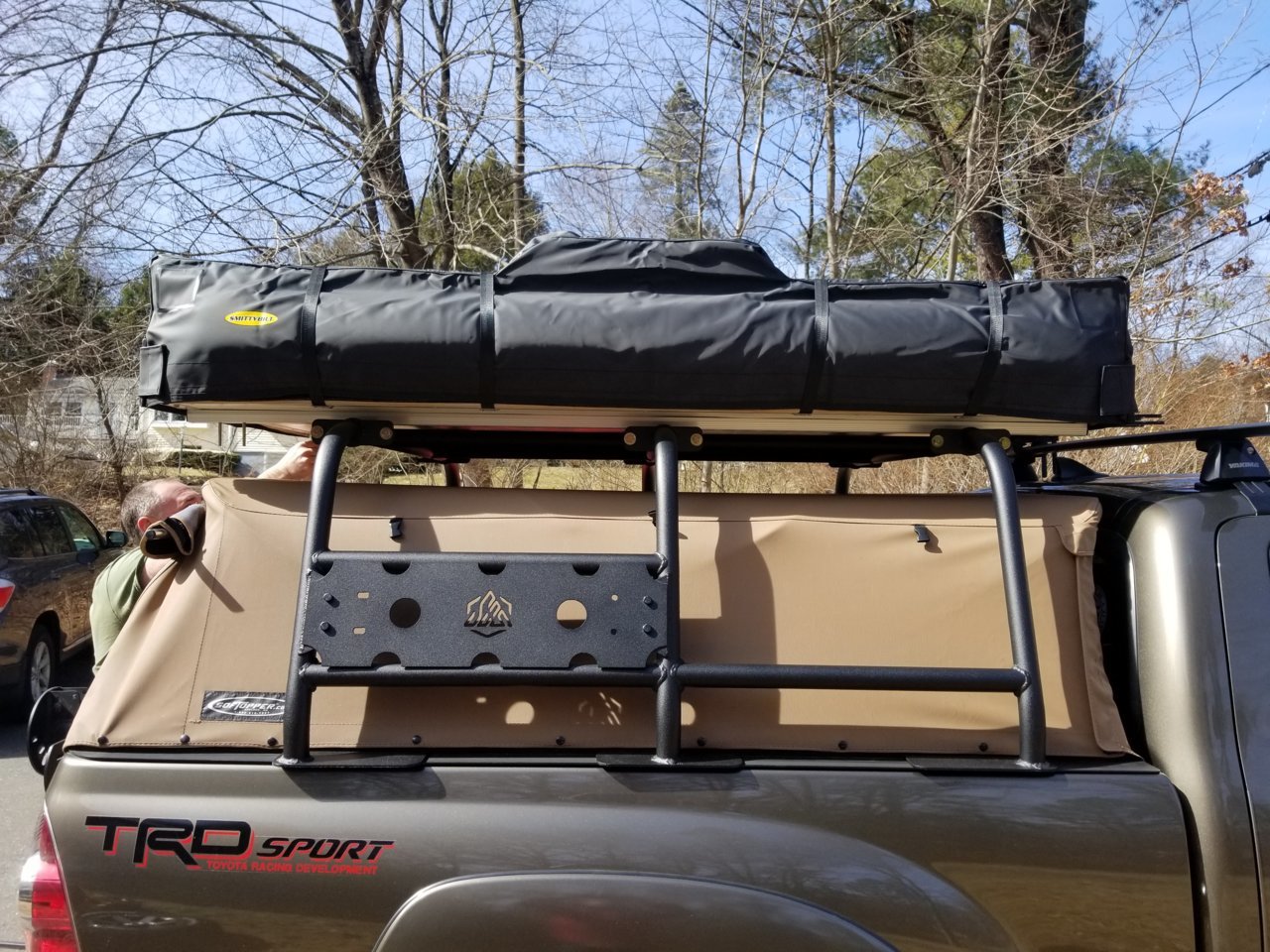

    @Unchained 5150 sos doesn’t show it on their website but I sent them an email and they said they make one for the long bed too, Is that the long bed rack or the regular size?

    @DesertRatliff do you know who’s taco that is in the 2nd photo? (The grey one w tan soft topper and orange maxtraxx)

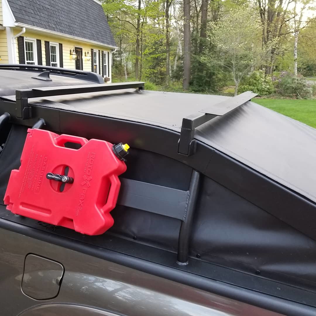

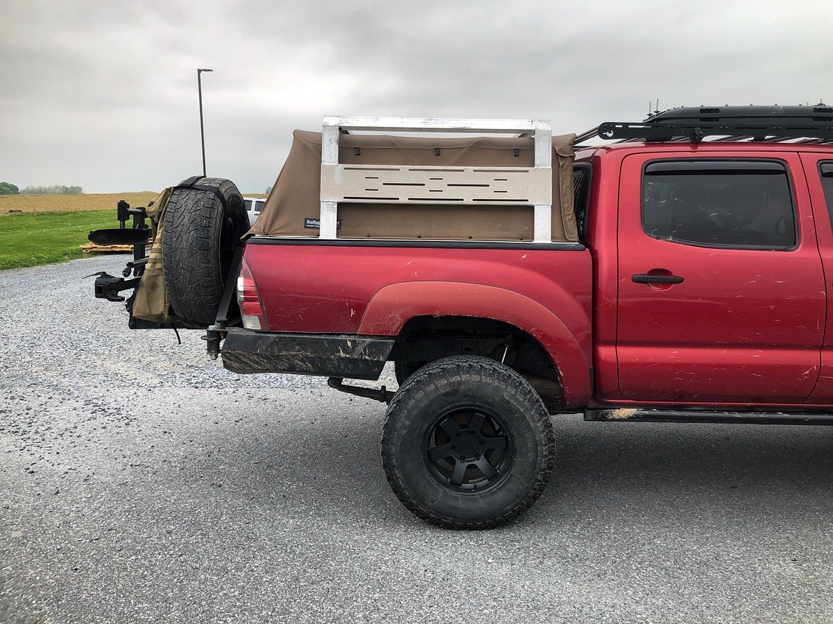

    Regarding your first point, IIRC the softopper swings in an forward AND upwards motion when collapsing, making a rack that's "tight" to the top renders this function useless. Luckily, the softopper is held in with two quick clips that are easy to remove from outside the bed or inside, and the whole topper can just slide out. The only type that can do that have either removeable top bars or don't hug the sides tightly
    I sacrificed this option to get the sides as tight as I could to the softopper:
