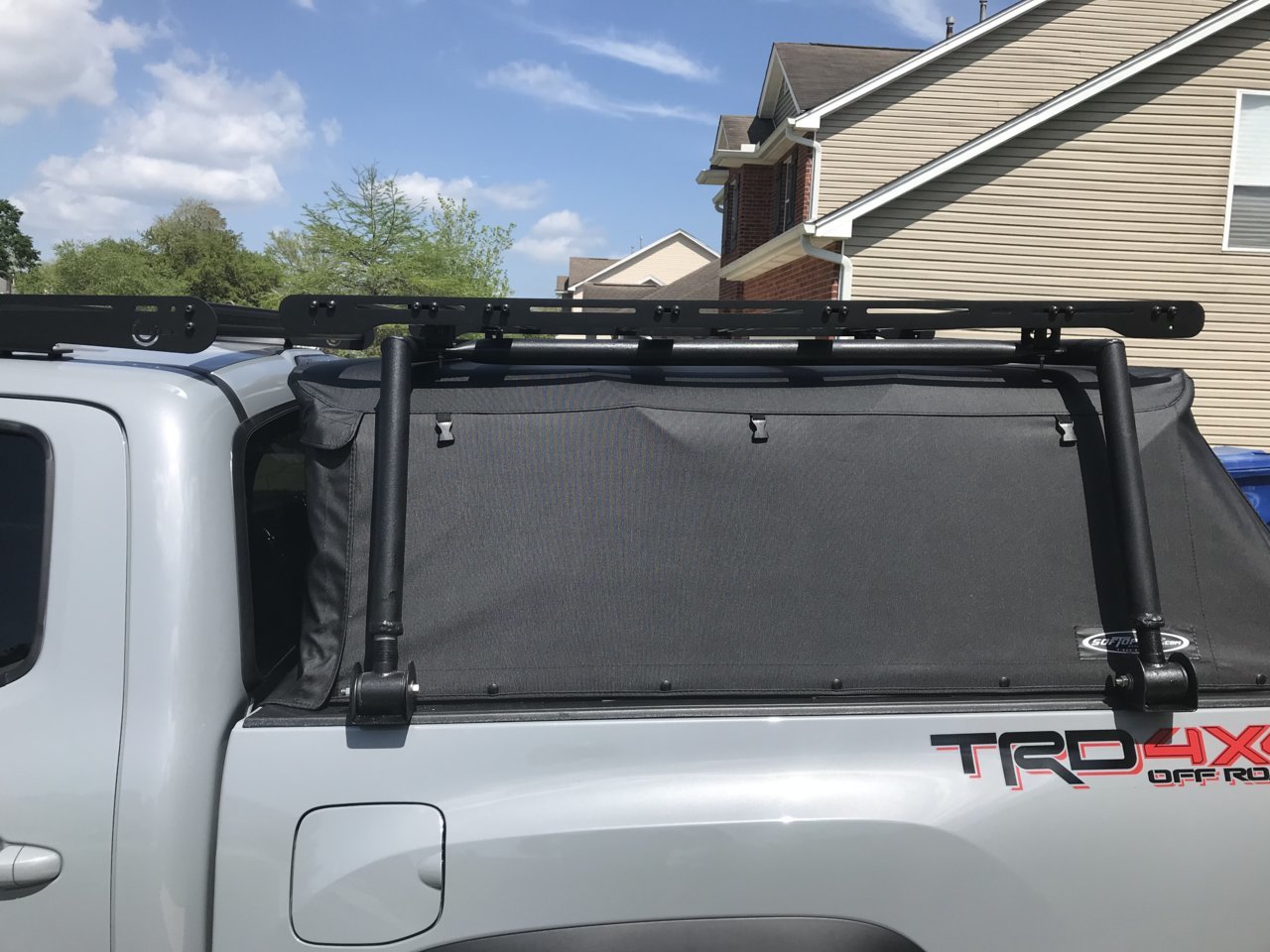

    yup! 5052 aluminum. It's extremely light and extremely strong!

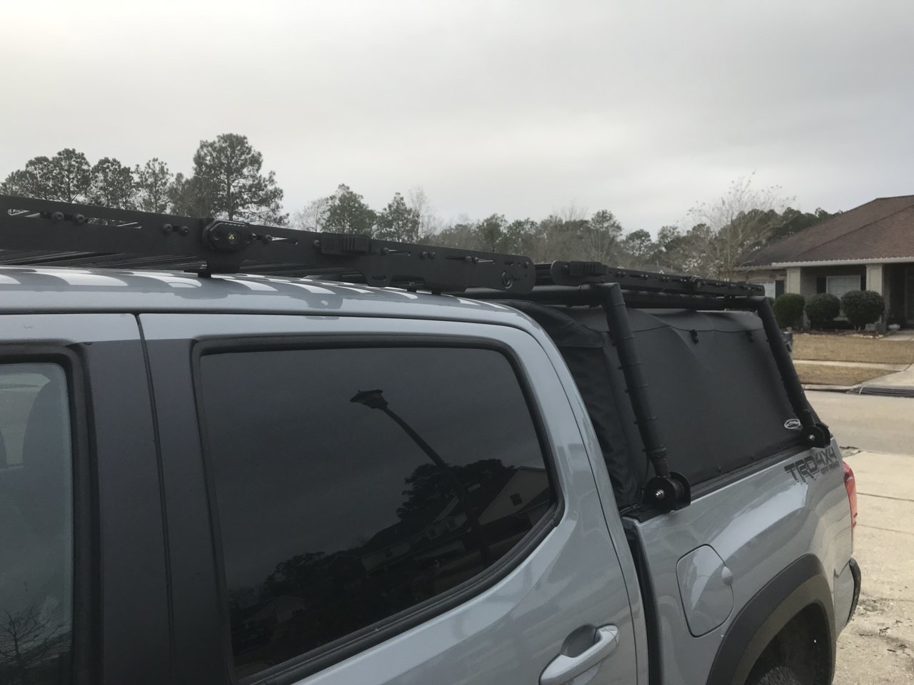

    Had one made locally this time last year, not crazy about the placement of the vertical supports though as they interfere with the button snaps on the topper. Also not crazy about the "sharp" angles of the 90-degree turns for horizontal supports. It's been a great rack (hehe) so far though.

    Would you happen to know what thickness tube was used to build yours? I'm thinking of rebuilding mine and want to go round tube instead of square but dont have a tube bender so I might angle cut/weld like yours is. Ever notice anything catching on the hard corners of the tube?
  13. Jul 19, 2021 at 7:19 AM
    #33
    captain_beefheart14
    captain_beefheart14 Well-Known Member
    Oct 16, 2019
    #308160
    268
    2019 Cement Off Road
    Prinsu racks, cab and top, light bar, rear and side roof rack lights, ARE Camper shell, blackout, TRD Grille, Anytime front and rear cameras, Truck bed box (DIY) Bilstein 5100 front, OME 2885 Coils, Ikon Stage 2 Rear AAL
    1.25" sch 40 pipe the OD is around 1.625+/-.
    as far as catching, no. Never caught, but if I had it to do over again I would go with the bent tube as opposed to the hard angle, simply for aesthetic purposes. The fabricator talked me into it. Don’t get me wrong, it works fine, just aesthetically doesn’t flow with the trucks lines as well.

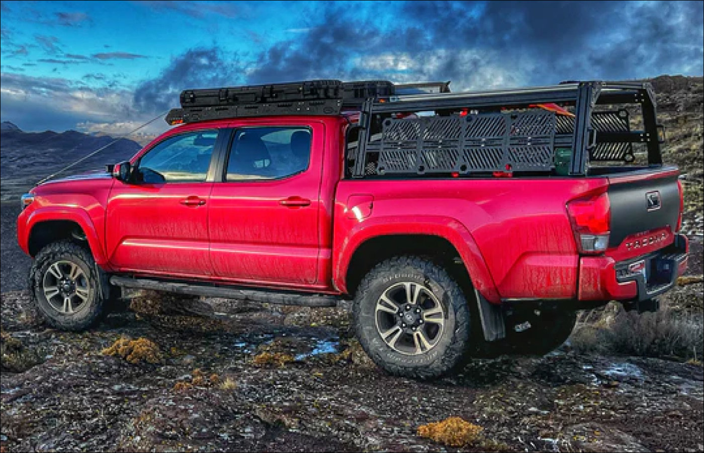

    anyone know what the best rack system is?
    like actually functions as a rack, kind of like a shell rack
    That holds things, and is not just a tube only capable to have an RTT slapped on
    (if using a Softopper, with or without a rack atop it, to sleep i simply open the tailgate and climb in)
    to have bars on the side and no gear seems like a waste
    shells can mount gear on the side. But unfortunately are heavy and stationary.
    as folks know, there is only so much stuff that can be bolted to a cab rack, and the short length of a cab rack limits ability to mount longer things like long awning, long WaterPort, etc
    an even better feature would be disconnecting center bars if you need to carry a fridge (the point of a Softopper)
    so far the only brand I’ve found that offers that is Xtrusion Overland
    even better if it can mount to nice looking flat upgraded KBvoodoo side caps, rather than faded old weird stock plastic
