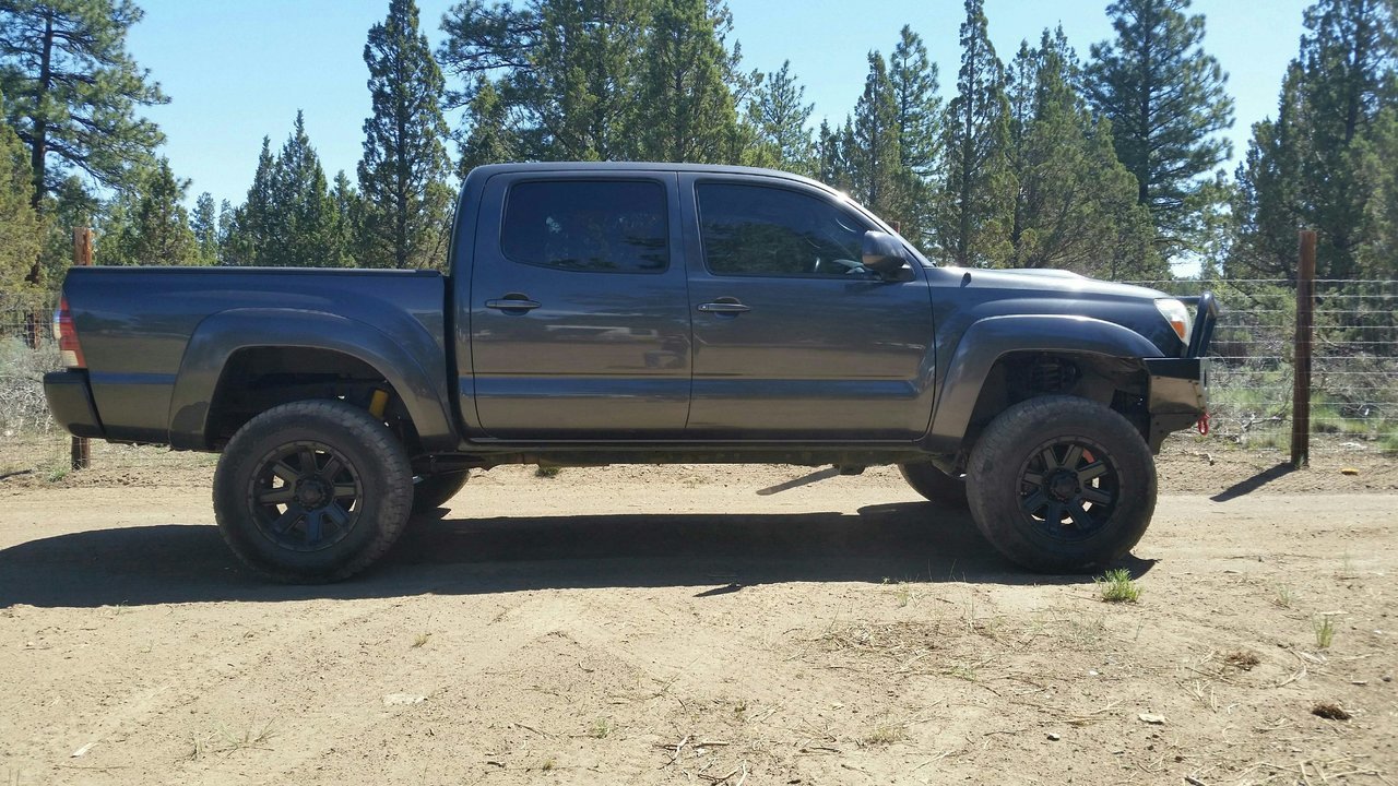

    @OZ-T , Should I expect my rear to settle a bit? Photo taken an hour after leafs were installed. 885's and dakars.
    I'll also be putting an ARE fiberglass cap on.

    OME lift. 886x springs, dakar leaf pack. Put 10,000+ miles on it so far. Off roading, hauling bikes and equipment in the bed along with trailers. Rear didnt settle too much.
    Center of hub to fender,
    Rear 26"
    Front 24"
  12. May 11, 2016 at 8:22 PM

    It looks level to me, it doesn't look like 2inch difference
