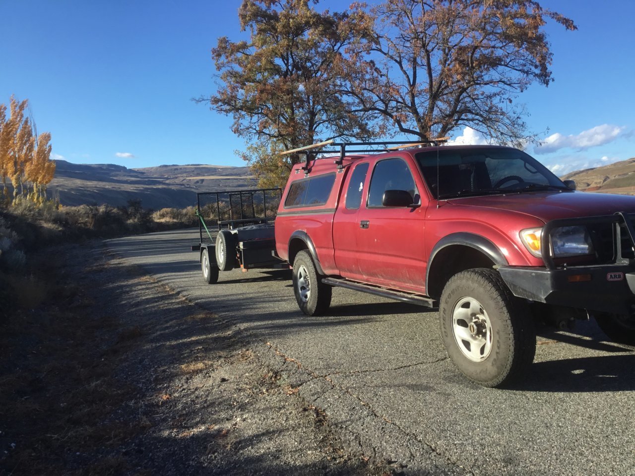

    34x9.5's for me. Actually they are closer to 33" than 34"

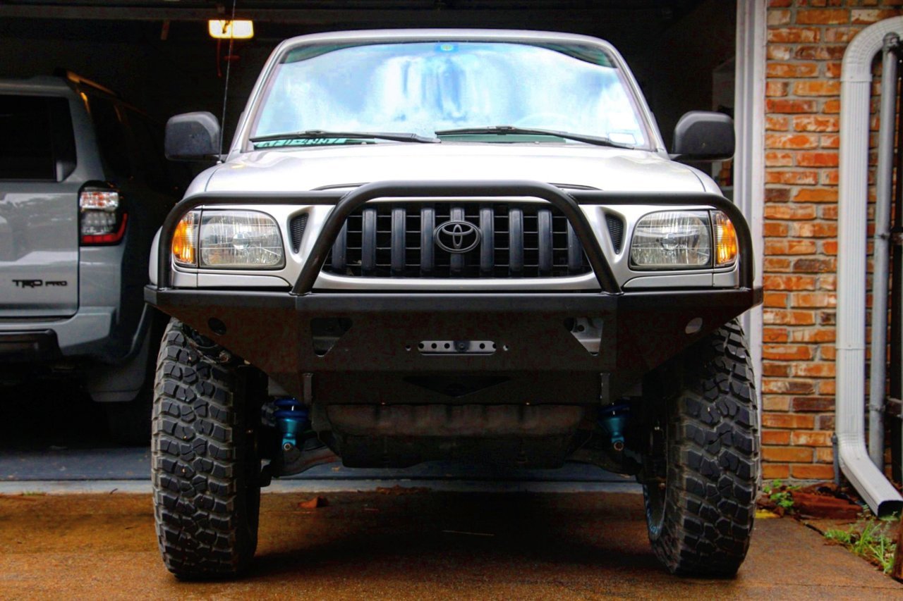

    Pizza cuttas 255/85r16

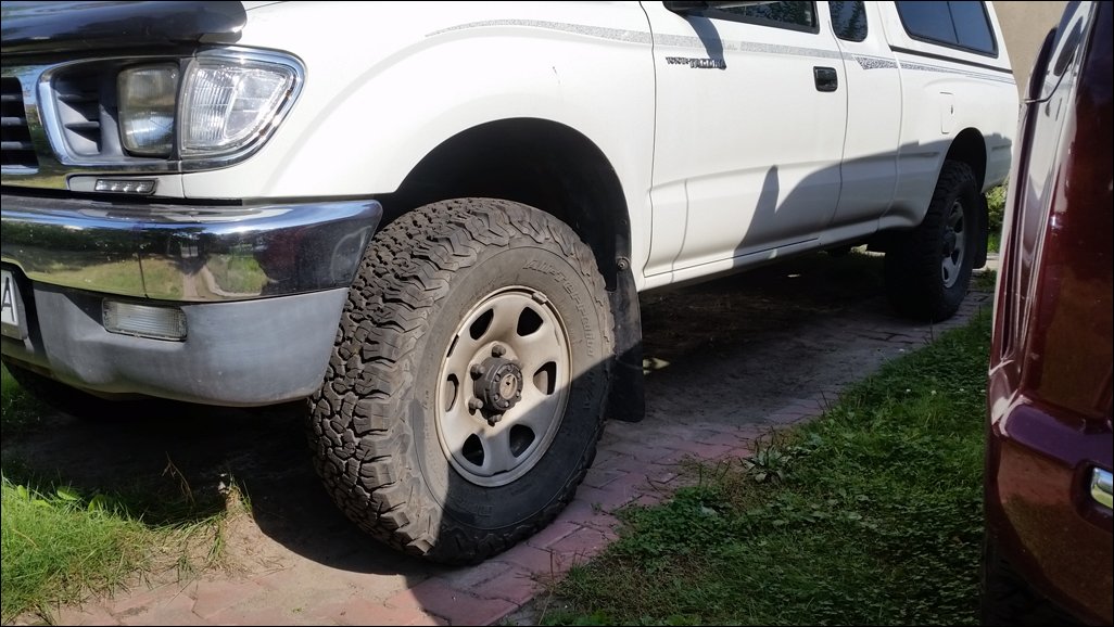

    This is BFG KO2 30x9.5R15. I have not seen any taller tire for 15x6 inch rim. The rim width prevents me from putting 10.5 wide tires. When i bought the truck 20 years ago it came with Michelin 235x75R15 M/S tires. They always look strange tiny. These KO2 are only 0.7 inch taller but somehow look 100% better and my speedometer is only 1% off (used to be 4% off). I wish I could fit 31x10.5R15 there, but on 6 inch wide rim it is a bit dangerous.

    What width are the stock aluminum wheels from the same era? I run 33x10.50 on them just fine.

    These Toyota wheel designs are 15x7.

    Mines the second one, I was thinking they were 7"s
