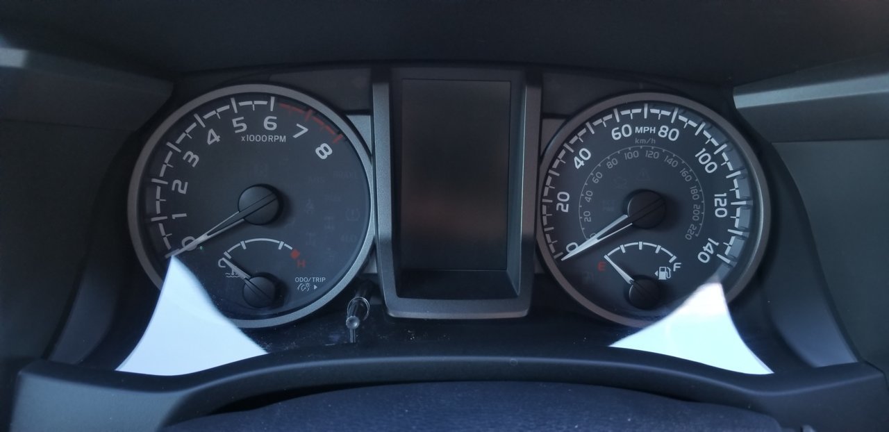

    So, picked up some of the Meguires Plastx and a swifter refill. Went lightly over the clusters with the swifter until no more visible dust, then a few drops of the Plastx on a Microfiber cloth, and very lightly and carefully using my fingertip to control the cloth, spread and buffed the cluster Guage. Immediately after, used the same cloth to carefully buff off the coating. Not a single scratch, and it came out amazing.
    Talk about nervous as hell doing this as I know how easily they are scratched. So, anyone else looking to clean the clusters, there ya go. About $6 in stuff, and being super careful, and it'll come out like brand new again. :D thank you everyone for the suggestions and ideas.

    Normally, I would just use an air compressor, but had windows tinted month ago, and it had spray spots all over it from that. Thankfully the tint guy didn't attempt to clean it off.
