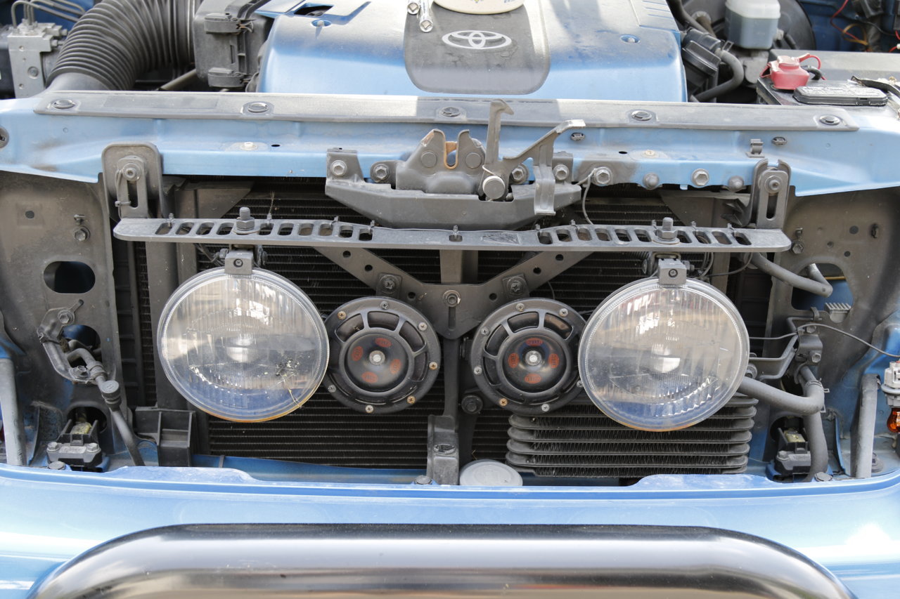

    Also, I see the three mounting points on the bracket and looked at the truck. In theory it makes sense but not sure about the center mount- where it goes and what it attached to.

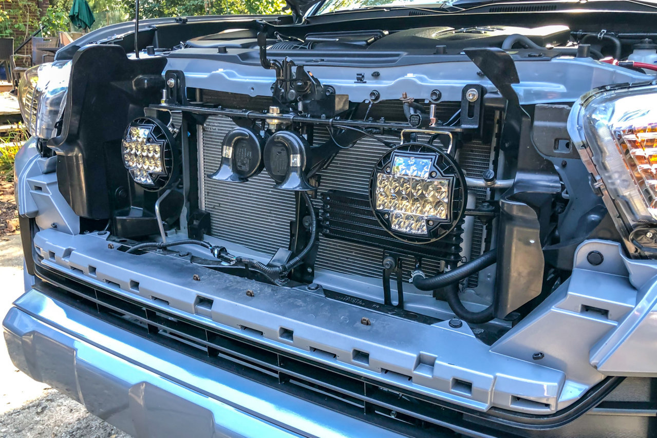

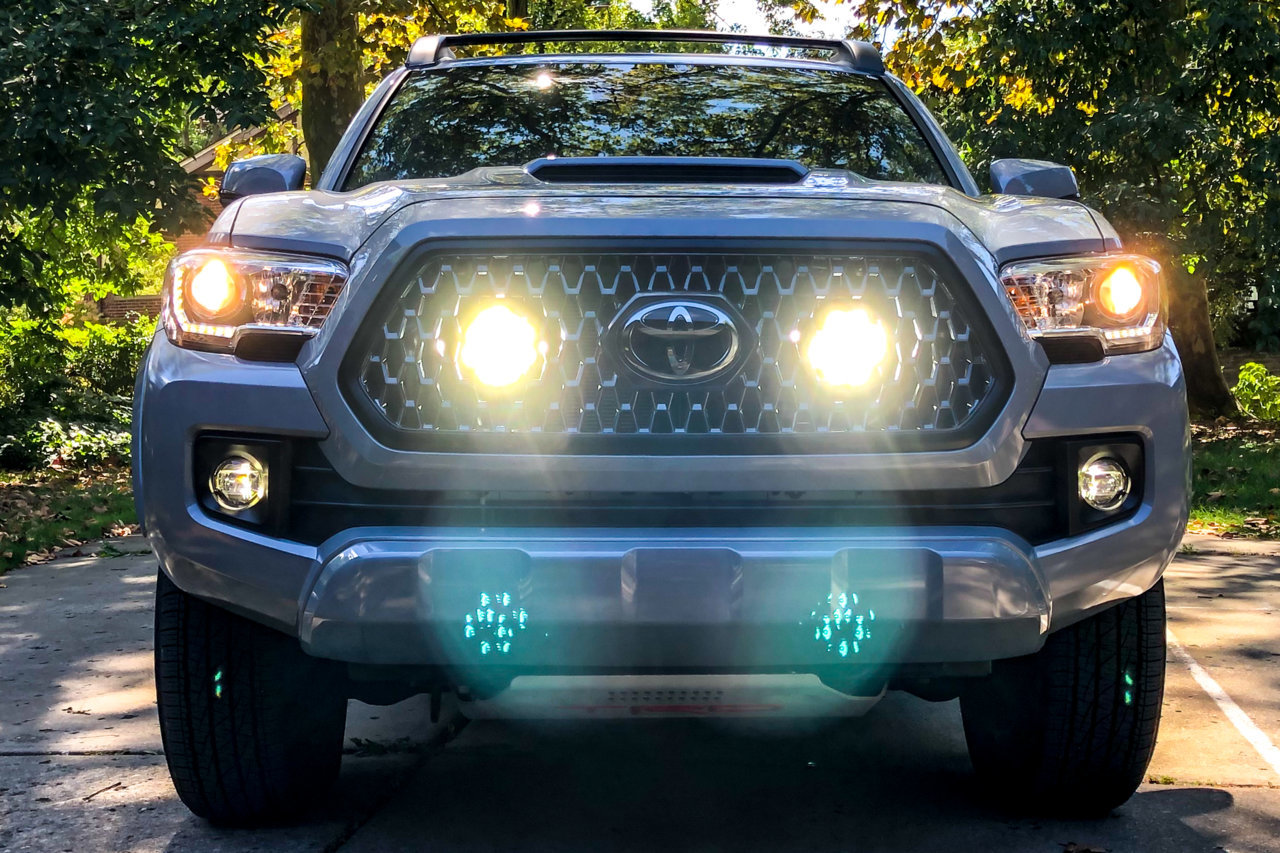

    I busted one of my horns, but did relocate the new aftermarket horns. I'm running round Rigid lights (I think they are 6"). The bar works great!

    I installed the SDHQ version today and install was a breeze. No horn relocation necessary.

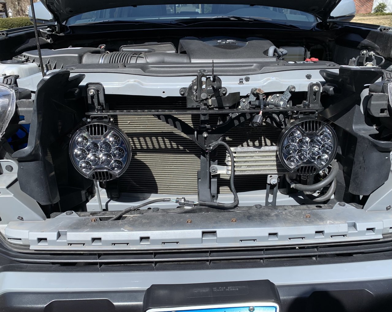

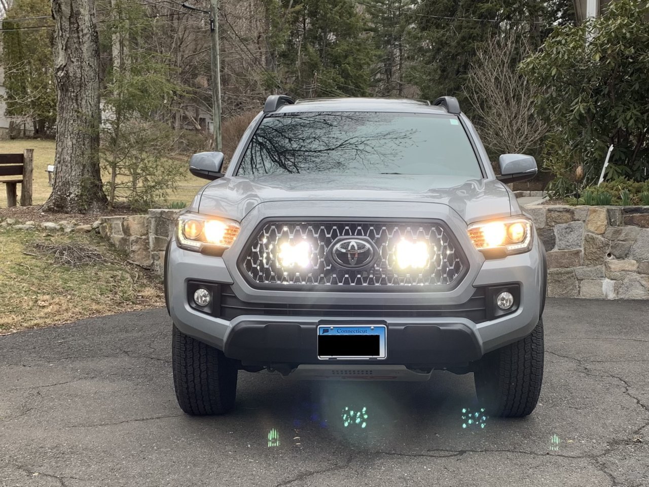

    Thanks everyone for the tips. I think I still have some adjustments for aim, but really happy with the results. The only downside is now my headlights and fogs look even worse. I guess some Phillips H9’s and SS3’s are next? I kinda love the oem-ish look though.
    Thoughts on KC fogs vs ss3 sport? I assume ss3 are juchbetter?
    btw, these are KC LED Slimlites inn the BAMF bar. Other than figuring in the horns (I flipped them, bent the bar a little, and there in 4 washers) it was an easy install. Running the wires through the grommet takes some swearing but is doable.
