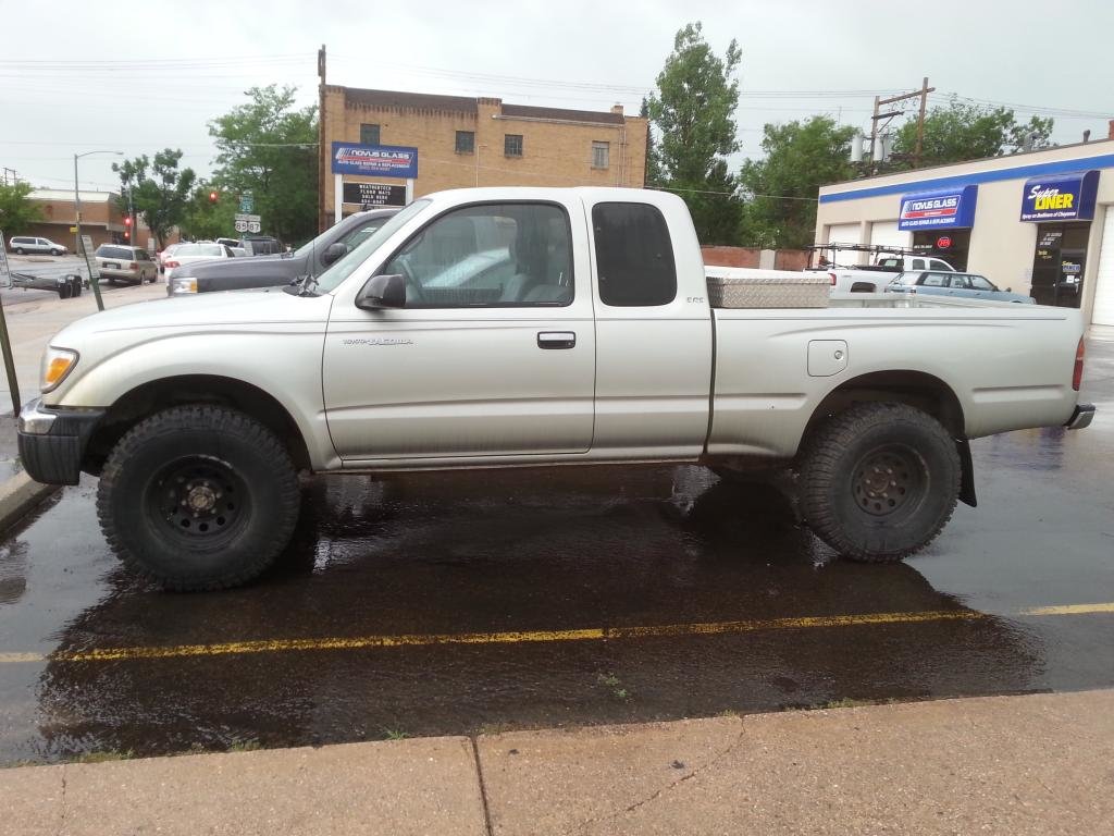

    This is my truck with 31x10.5 KM2's that I put on my truck prior to lifting. And this suspension was VERY worn out. The front suspension would bottom out going over bumps on the highway. You will be fine.

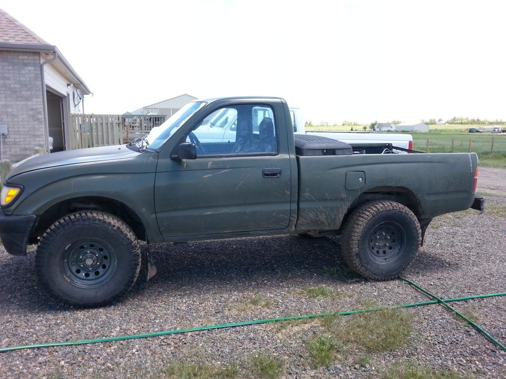

    20140603_130929_zpsacanwpbp_37163411851f2f8cfaec0d7eca7b28a1d9b42f73.jpgURL=http://s133.photobucket.com/user/NdIndy/media/Tacoma/20140627_134510_zpsp7yzstuc.jpg.html]20140627_134510_zpsp7yzstuc_9752ec88cfb3657c738649645b85bc8ccfa7759e.jpg[/URL]
