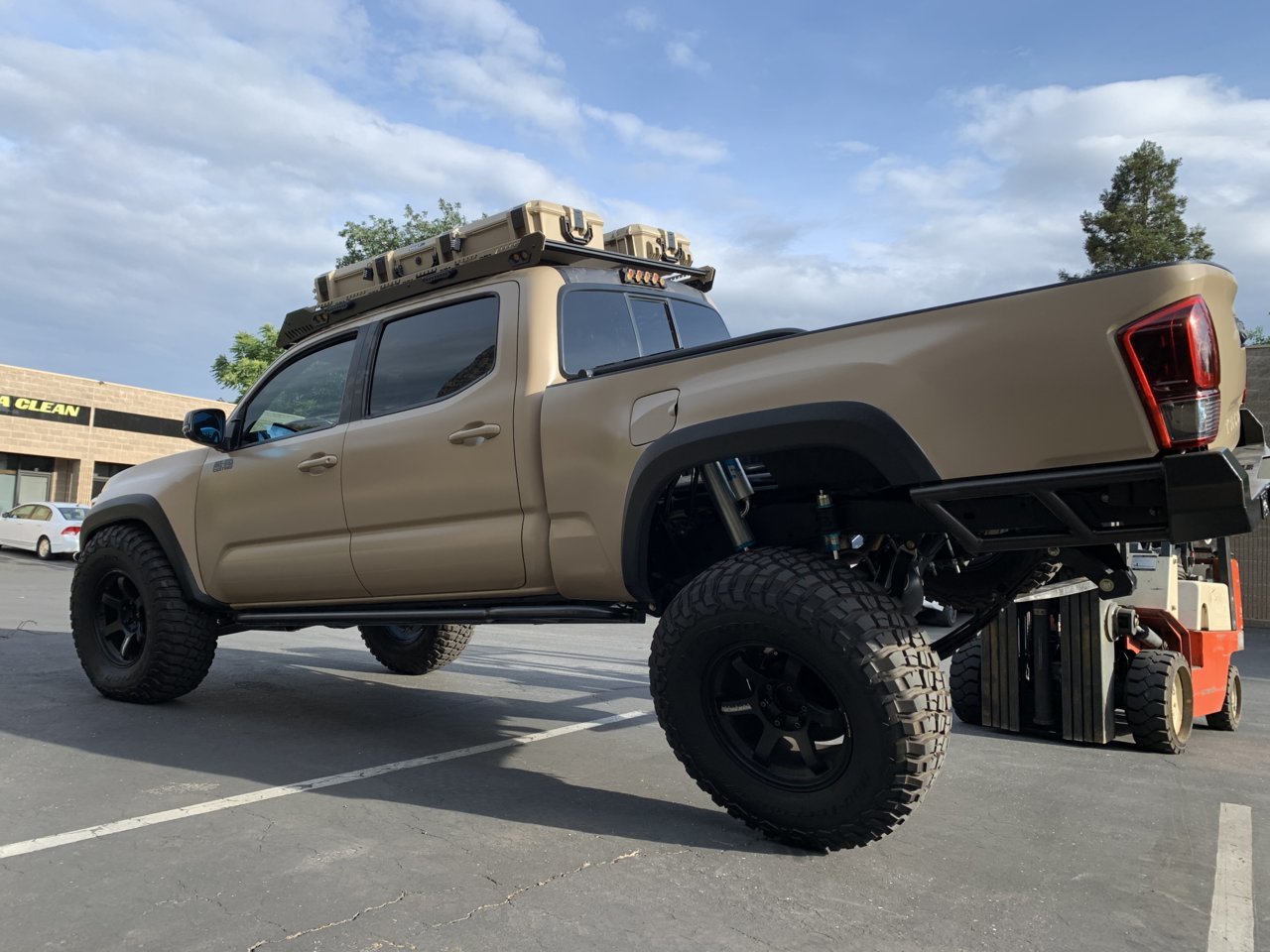

    They look trimmed at least

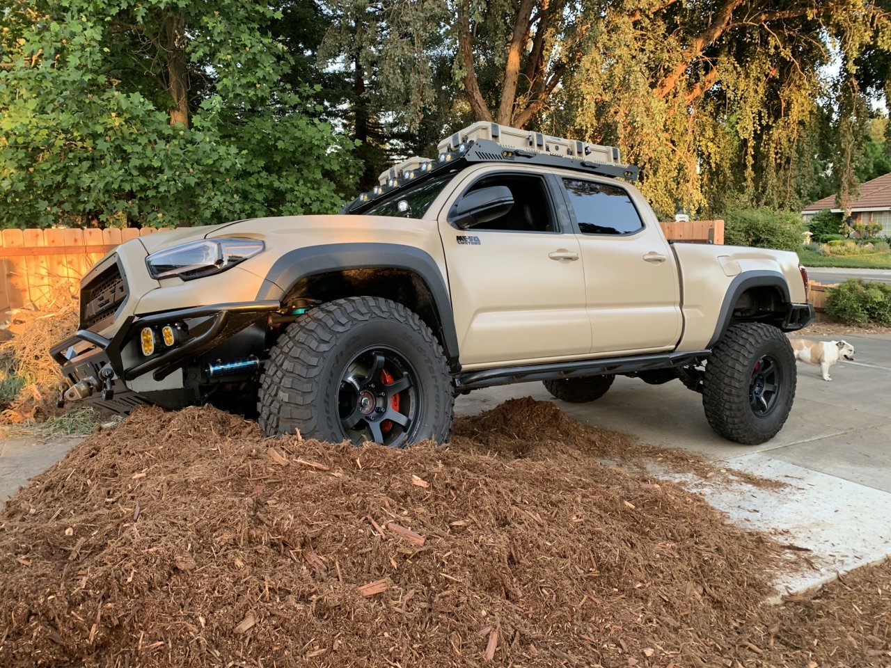

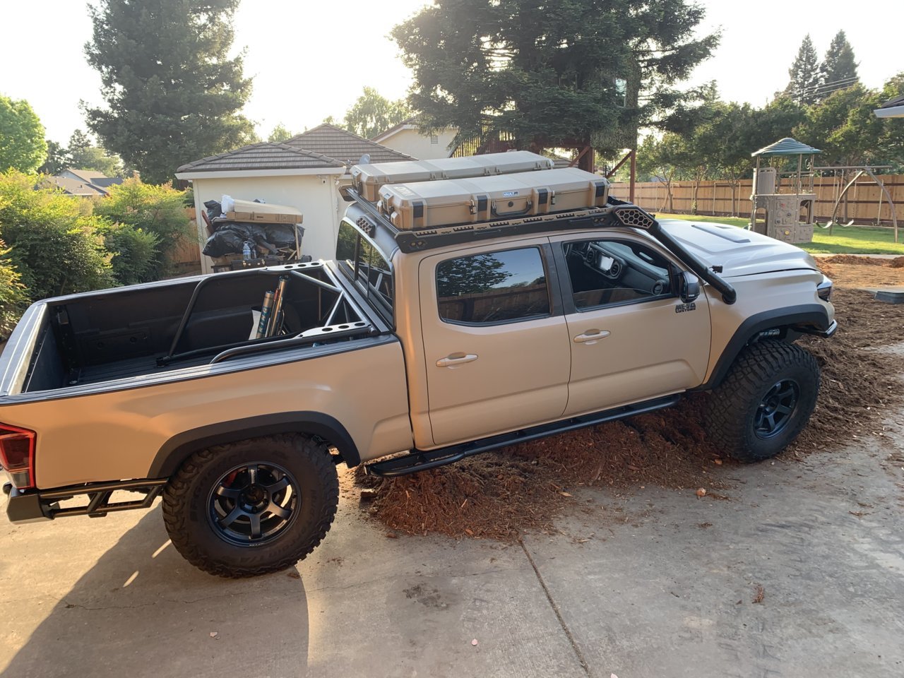

    Only flexin I can do:rofl:

    poster states 1.5-2" cut fenders. cab mount relocated, hammered inner fender, full forward alignment with spc arms. im sure it still rubs terribly with any flex

    They are 37x17.5x18 but the KM3’s run small(actual measurement 35”) which is why I chose them

    Sorry I typo’d the heck out of that. I meant to say tires are 37x12.50x18. KM3 measures closer to 35”

    I have that same tower playset for the kids

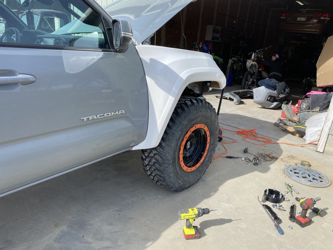

    That’s my old 2006
    6” suspension
    3” body
    cut the cab mount down and bashed in the cab lol

    Personally I never had any problems running them for over a year and am currently working on 37s again
