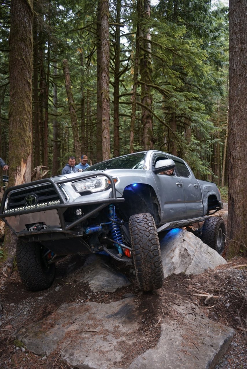

    so with 37’s, what front end and steering upgrades have you done? Tundra or LC rack? I’m on 35’s and ready to upgrade next summer I think when I need new rubbers…

    I tried running the tundra rack, blew that after 8 months of wheeling, so just run $100 junkyard stock racks now. So far the 200k mile rack has lasted the same time the Tundra one did. Running stock tie rods and tie rod ends, no point in beefing those up as you will just force the rack to be the weak point, and rip the steering bungs out of the frame unless you plate the frame.
    The Tundra rack is also a bitch to get in and out, even with lifting the motor mounts up 1" like I did.

    Any thoughts on the JD fab steering rack brace? I was gonna do tundra rack but I’ve heard about people blowing it multiple times now.

    Doesn't work on a 3rd gen since the oil filter setup is in the way, so gotta relocate that.
