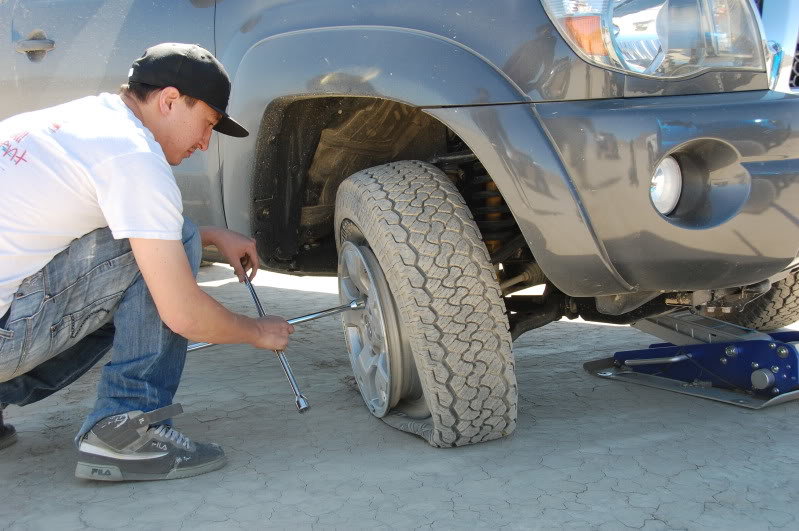

    yea, I just throw the jack either under the LCA/cross member or the rear axle and it jacks up in 3-4 strokes, and the skid plate makes it stable in rough terrain, plus the whole thing weighs less than a hi-lift

    Its not exactly how stable the bumper is but more so the highet the highlift will lift it. My 60 inch jack runs out of room quick when i lift from the sliders or the body so i ratchet strap the axle to the frame so i dont get any droop. So i can actually lift it enough to change a tire.

    not really if you look at it, its pretty flat

    Pretty safe in the desert and sand too. Most guys who are serious about prerunning have a floor jack with a skid plate base.
