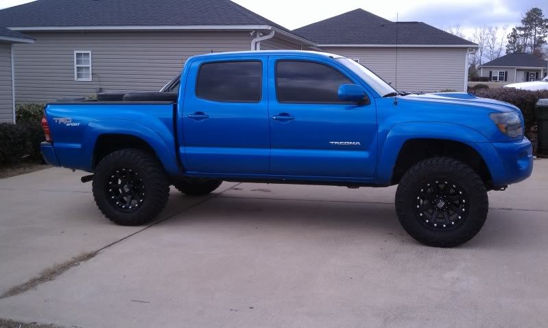

    These are Trail Grappler, but they are Terra Grapplers in 285/65/18 with a 2.50 5100 lift and 1/4" top plate spacers.

    thanks....Hows your rubbing issues with that combo??

    I'm not rubbing at all now and I still have the mud flaps on. I had to trim a good bit of the plastic splash shield close to the front bumper and had to trim about 1 1/2" from the end of the fender flare in the front. Also, I cut about a 2" section out of the mud flap where it was rubbing and the rear of the fender flare.

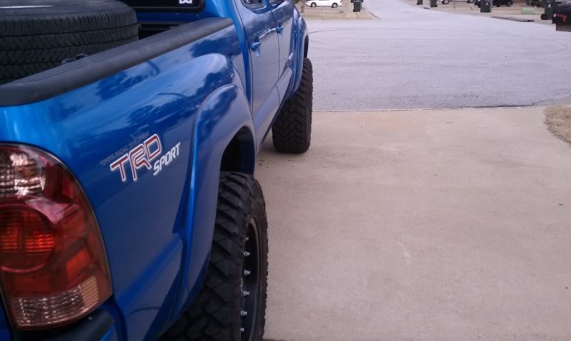

    I am. I'd believe they aren't a true 285, they are just about the same size as the 33x12.5's on my jeep.

    Cool....anymore pics that show a different angle or more light on the wheels/tires?
    Yea Nitto's website says that their 285 Trail grapplers are 11.8 or 11.9in wide :)

    IMAG0178_1f448eee95411ae28fe483d6b1376cfffa863bc8.jpgIMAG0179_02896fe67376da4e2f738c05e03841cafb52bb06.jpg

    And those are 285, correct? whats the rest of the size? thanks! oh, i see in your build now....yea they look fukn great! im get'n the trail grapplers for sure :D

    You'll love them. I have no complaints about them so far.
