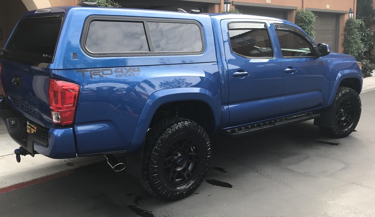

    This is my blue. It’s not the one pictured on first post. But pretty damn close 2” OME lift. 275/70/17 KO2s, i think those are 275s on the first post. 265s would look smaller
    These are 265 RidgeGrapplers.

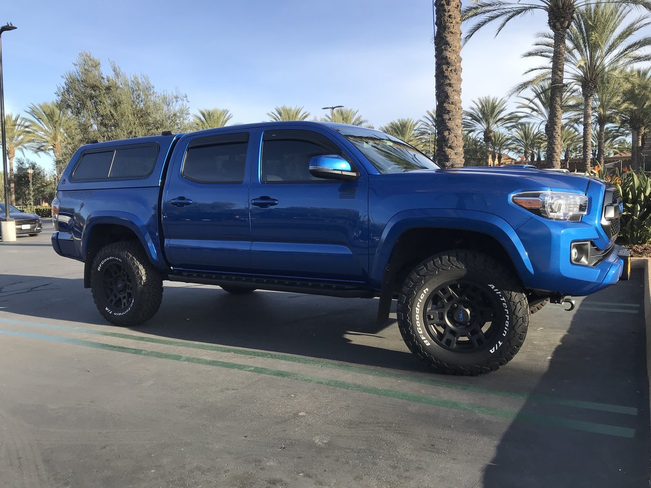

    I am very happy with it. I did have very minor rubbing going into my driveway so i have since added a 1/4 spacer from Headstrong Offroad to correct that. If I were to do it again I would just do the next coil up. I think its a 887 over the 885.
    This is it with the added spacers. You can't really see the difference, but it was enough to correct the slight rub.

    Beautiful! I have been going back and forth between 885 and 887. So the 885 with the 1/4 top place spacer is basically the same as the 887s?

    Yes. 887 is probably 1/4" or so taller than the 885 with the spacer. My truck with the 3 leaf progressive add a leaf and the overload spring still in sits absolutely level.
