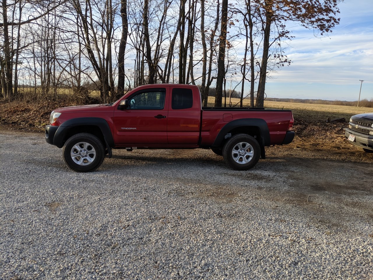

    08 Base 4x4 2.7 Access 5spd
    Stockish
    265/70/17 in an HT. I'll go to an AT when these need replaced. Good ride, fill the wheel well decently.
