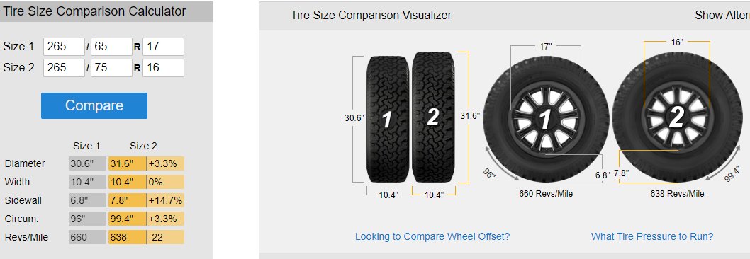

    More sidewall is pretty much the only advantage. I went from a 265/65R17 to a 265/75R16 and I gained like 2 inches of sidewall. It can be aired down a lot more and I think it performs better offroad.

    That's not a 2" sidewall difference. It's a 1" sidewall difference and 1/2" of additional ground clearance. Normally, people are sticking with the same size wheel which means they would only gain 1/2" of sidewall clearance with a 31.5" tire compared to the stock 30.5" tire. By downsizing the wheel you were able to get an additional 1/2".
