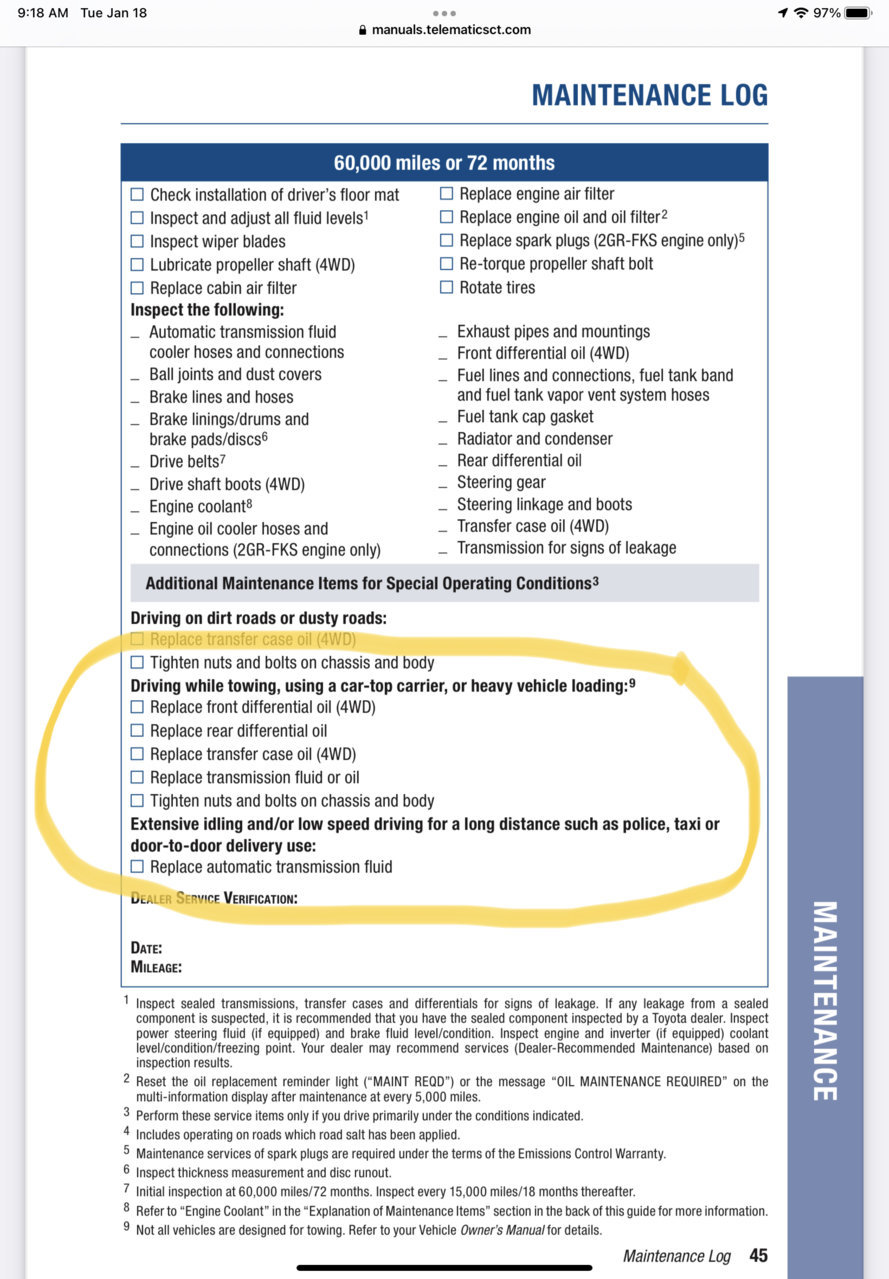

    Toyota says not to replace ATF till 100K miles, why do I see recommendations on this site for people to change ATF at 50K miles or sooner?
    Follow manual for oil, but not for ATF? Why?
    If anyone think that dino oil can take timing chain beating and stop and go traffic, with hours of idling at the red lights (like in ITP Atlanta traffic) for 10K miles...more power to you.
    Toyota's responsibility for your engine stops once warranty runs out.
    5 qt jug of synthetic Valvoline Synpower, M1 AFE, Shell Truck & SUV is $10 (buy on sale and stock up). Filter is $6. $18 (5+1qts + 1 filter) for a DIY synthetic oil change. I may push synthetic oil to 8K in the timing chain engine, city/heavy traffic; 10K miles, if there are several long (600 miles+) interstate trips. Do the same on Group II or even II+ dino oil???? No way, no how.

    Might this help answer your question?
