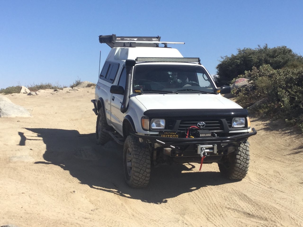

    I rather have it and not need it then need it but not have it. i used to carry it around in the bed and put put it in my garage (mon-fri) then on the weekend I would put it in the bed .....let me tell you something that thing weighs a TON!!!! So when I got my fromt bumper I just permanently put it ther, I habe no regrets I dont even know its ther tbh and I have no regretsD56B7E19-CD43-4916-BABB-E0AF9C48E40D.jpg

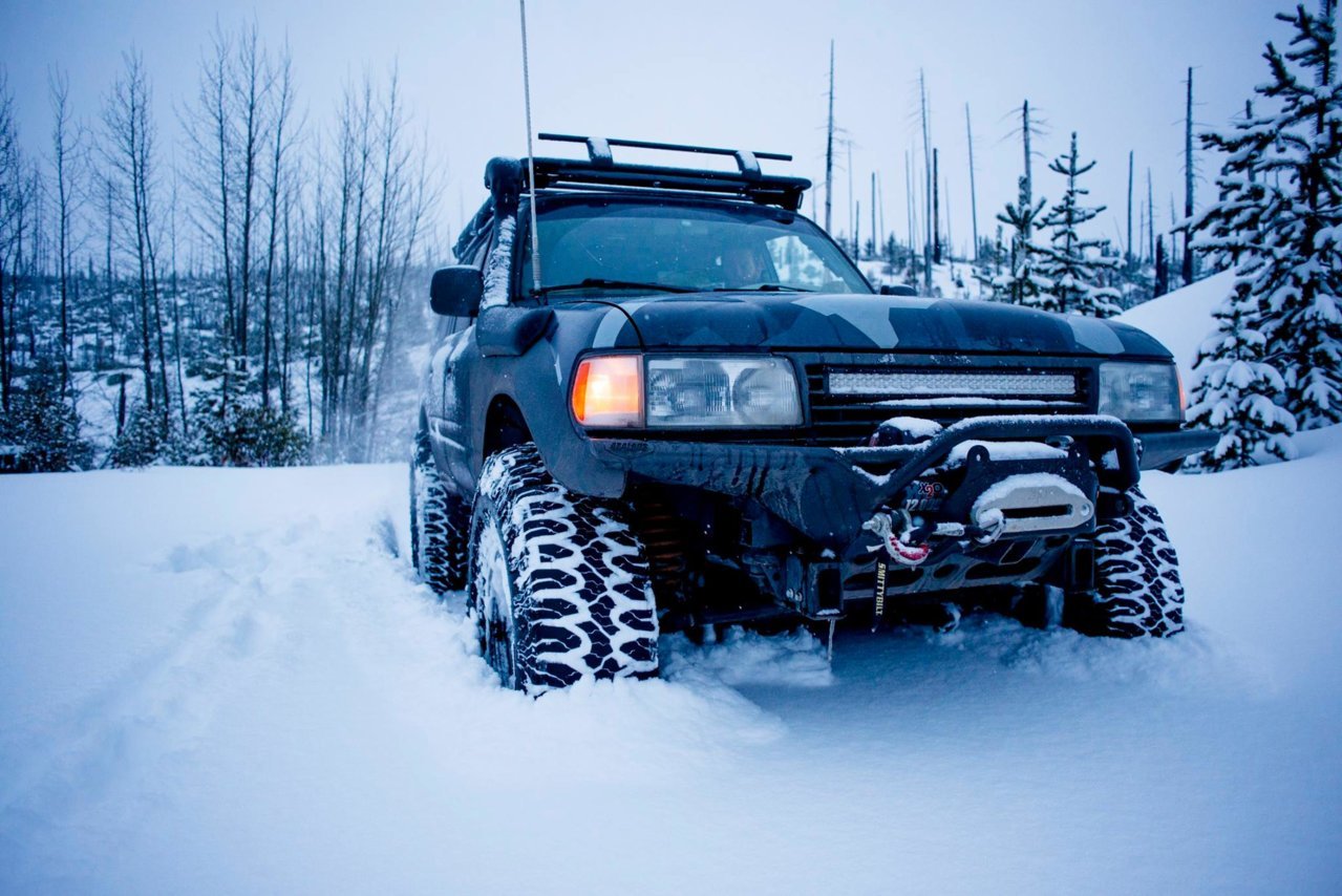

    I get paid to recover people every year during snow season, I contract out to the local tow companies and they pay me to go recover their customers not unlike matt(99% its snow as we don't have a trail system like Utah and matt does).
    I also run Central Oregon Landcruisers and we do alot of snow wheeling, we run a mix of different types of runs, We will have open runs that anyone with decent tires and recovery points are welcome to join to closed limited runs that are just built rigs on big tires and experienced snow wheelers.
    I have some experience with recovery but do not claim to be an expert and learn new things and new ways to both wheel and recover every year..
    With that said..
    I run all winter in the snow and see a decent amount of water crossings. In my experience my first choice is kinetic rope if the customer/member/random person has the attachment points im going to use that 100% of the time first. Second would be the winch its just slower, its a tool I would never be with out offroad and in the snow. I keep debating adding one out the rear because there are times its just a pain to move yourself backwards.. If we are talking SELF recoveries 100% winch its the BEST tool to have with you followed by a SHOVEL and a AIR DOWN TOOL... I cannot tell you how many times I have rolled up on someone stuck and I just aired them down and they drove out.. I run Winches with synthetic on everything and have never had to rebuild a winch for snow and water, though I did see a couple relay boxes fail because of water...
    Recovery tools for solo off road running #1 Air down tool, #2 shovel, #3 winch.
    Recovery tools for groups #1 Air down tool, #2 kinetic rope, #3 shovel, #4 winch
    To recovery people same as group...
    Notice high lift jack is not on that list...

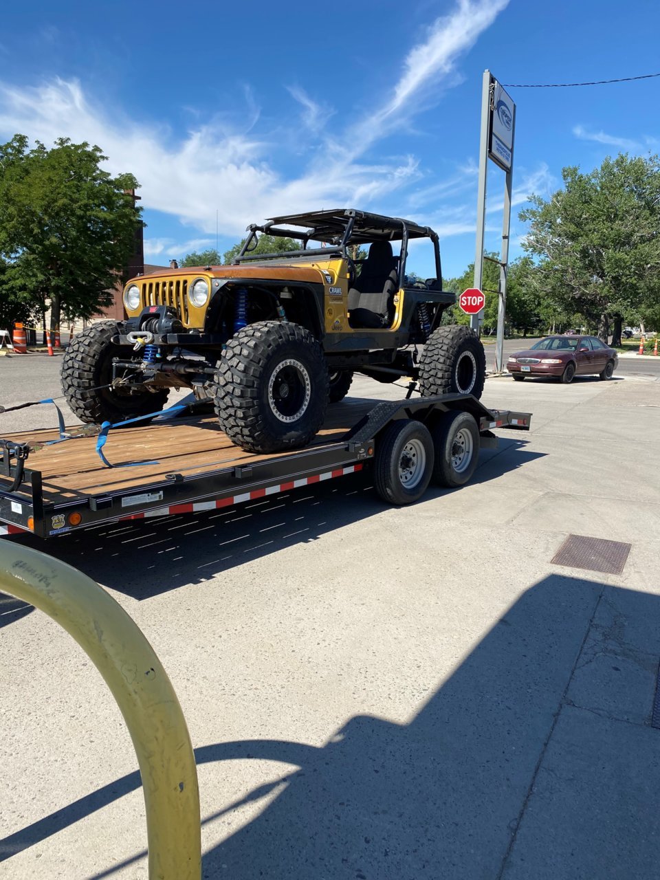

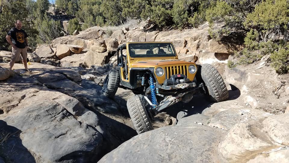

    Typically you only see this on very built crawlers, not usually something you see on a adventure type vehicle
