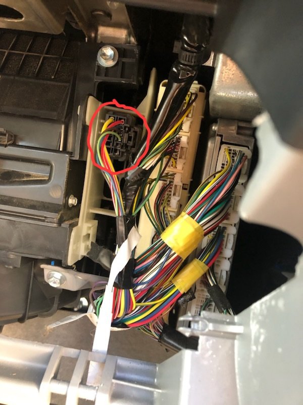

  10. Dec 25, 2022 at 10:13 PM
    Dm93
    Dm93 Test Don't Guess
    Mar 3, 2015
    #150066
    12,778
    Texas
    2014 DC OR 6spd 4x4
    Predator tube steps, Ranch Hand grill guard, Magnaflow CatBack exhaust, Toyota tool box & bed mat, 2LO Module by @Up2NoGood, Rearview Compass/Temp Mirror, Tune by @JustDSM.
    That fuse feeds alot of stuff but we can narrow it down some, unplug the IH1 connector behind the glovebox (you may set codes in the PCM doing this but they can be cleared) and see if the fuse still blows.

    Steve
    2008 Tacoma
    Un
    unplugged it and fuse still blew

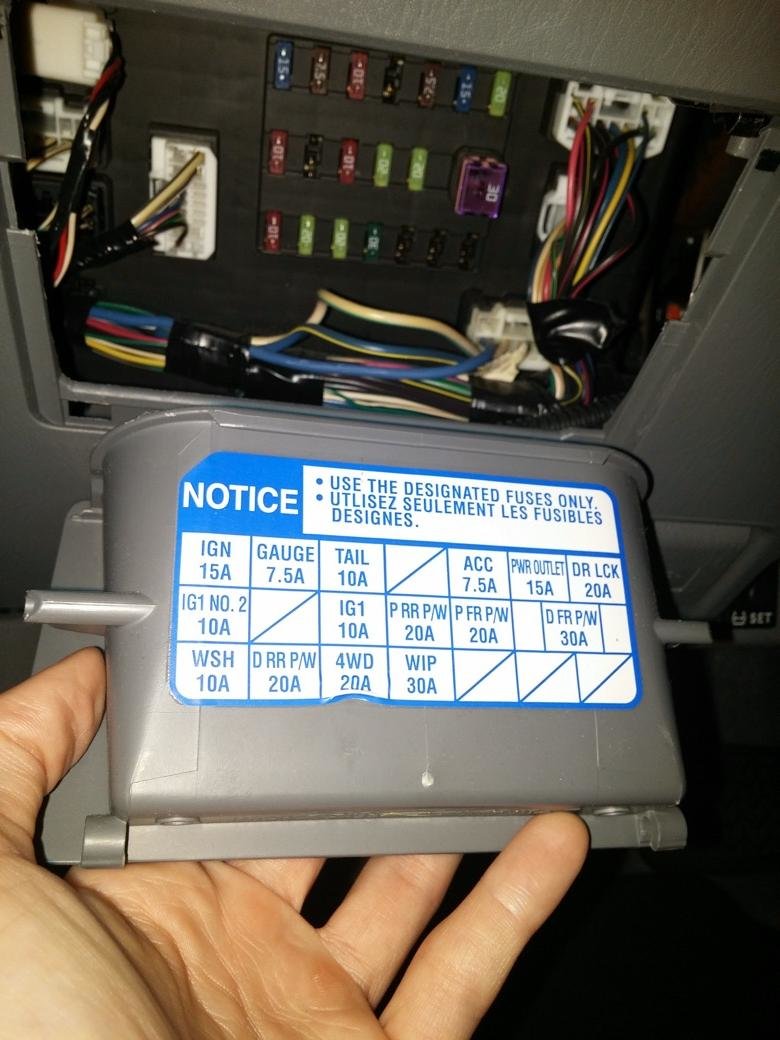

  14. Dec 26, 2022 at 7:37 AM
    Dm93
    Mar 3, 2015
    #150066
    12,778
    Texas
    2014 DC OR 6spd 4x4
    Just to be clear this is the fuse that's blowing correct?
  15. Dec 26, 2022 at 7:37 AM
    sc98cbra
    sc98cbra [OP] Member
    Dec 25, 2022
    #413961
    13
    Steve
    2008 Tacoma
    No, the one to the left of that IG1 no2

  17. Dec 26, 2022 at 7:45 AM
    #17
    Dm93
    Mar 3, 2015
    #150066
    12,778
    Texas
    2014 DC OR 6spd 4x4
    Ok that fuse feeds even more stuff, the easiest thing to start with would be unplugging the alternator and if that's not it inspecting the wire to the alternator paying special attention to the light green wire.
    I'm working on the list of stuff it feeds if that's not it.
    MSN88longbed and winkel like this.
