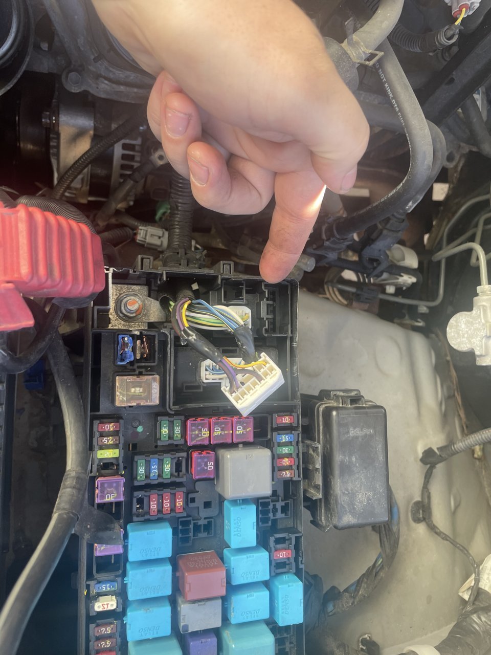

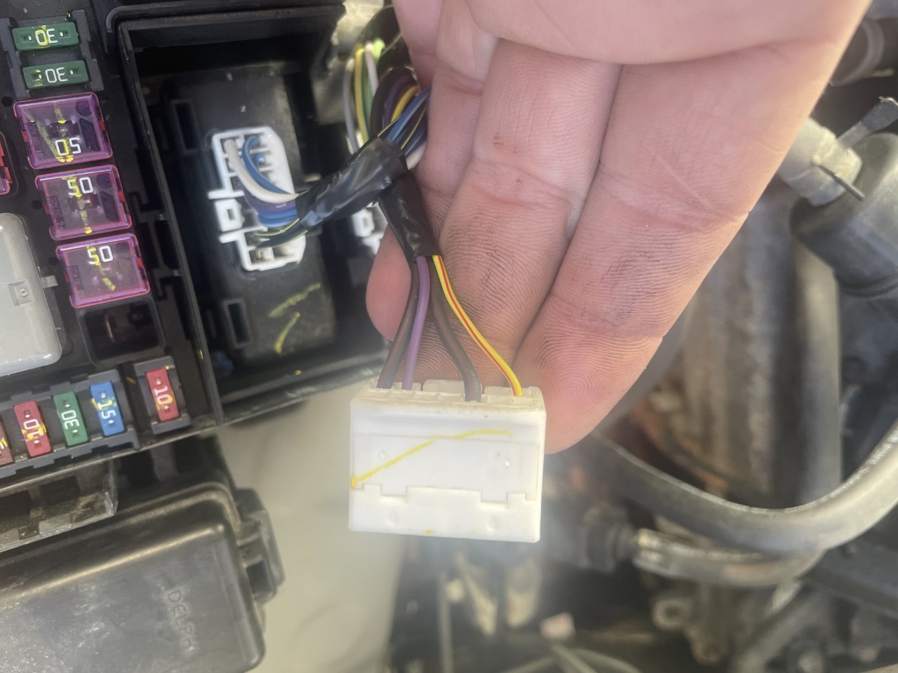

    It’s one of these wires. Pulled from the fuse box and didn’t blow the fuse

    That's interesting I don't see any light green wires on that one, I cant tell what connector that is from that angle. Can you show where you unplugged it from?

    Right here.

    It looks like this set of wires feeds under the engine cover

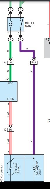

    That's EA1, The only thing I can find on that connector related to the IG1 No2 Fuse is the wire going to the A/C Compressor, plug that back in and pull the MG CLT Relay and see if your short is gone.

    You are a life saver! It worked!
    The pulley on my aC just started knocking/clicking. So my guess is that’s the problem!

    Glad you found it, the bad news is it probably needs an A/C compressor.

    You may want to pop the belt off and check the bearing in the A/C Compressor pulley, wouldn't want it to lock up on you and throw the belt;)
