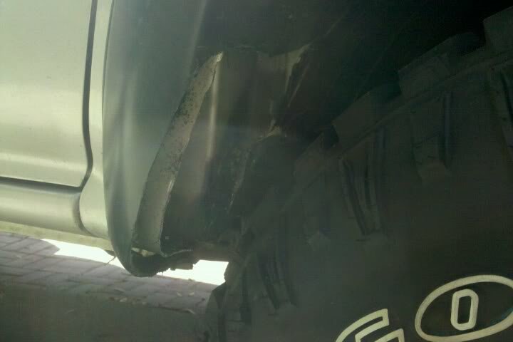

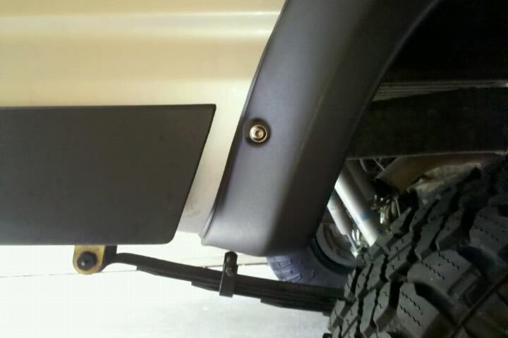

    Okay so I have 15/10's with a 3.76" BS with 33/12.5's and I needed bushwhacker cut aways to fit in the front without rubbing on the fender. After the install i do not rub on the fender at all on the "street" I still haven't been wheelin sense I installed them I'll let you know if i rub after Saturday :D. As for the fire wall I'm rubbing pretty bad off road at full stuff but i don't have my sway bar on so i can stuff the tire all the way up to the bump. I'm tubing the fire wall to stuff 35's when i buy my next set of tires.
    Okay for you A 15/8" with a 3.31" BS and a 33/11.5 shouldn't be that bad. I mean your going to have to do the pinch weld mod and some flair trimming but it shouldn't be too bad defiantly not as bad as mine.

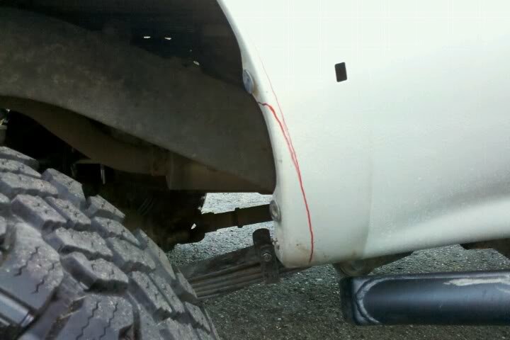

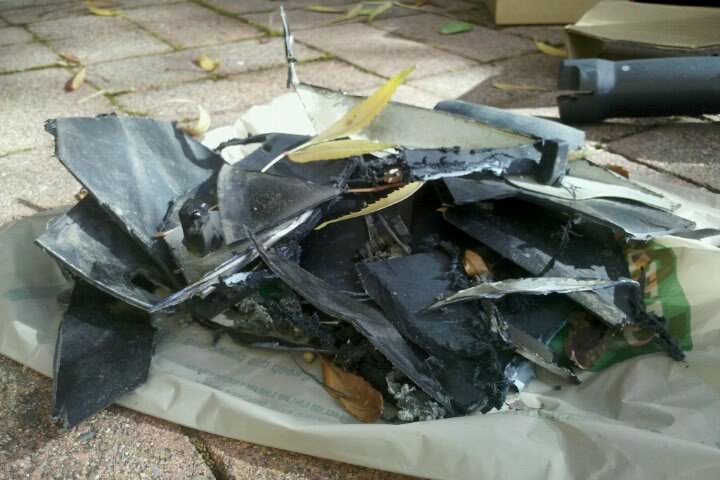

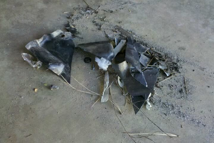

    Well it what I did is cut my fenders to be ready for the cut a ways. I don't think you would have to cut the fender it self all i had to remove is 1" to clear it so with that size it would most likely just be the plastic flair you would be trimming.
    This is how much you will cut for the cut a ways this is the rear.
    And installed.
    and this is what i removed from the fronts just to take the truck off road i still rub pretty bad.
    and the piles of shit removed and that's just the fronts.
