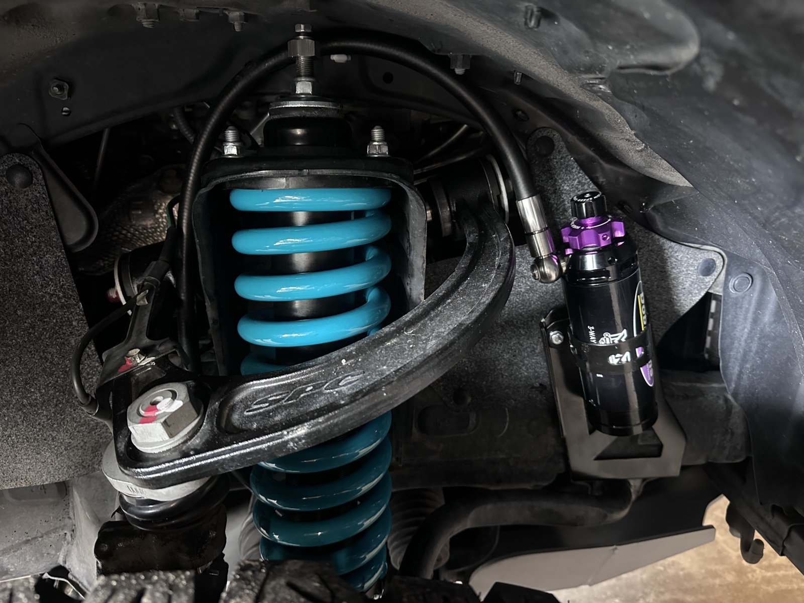

    Anyone running their UCA’s? Wondering if their ball joints are compatible with oem. They mentioned sankei but i’m not familiar with that brand. They also mentioned moog but doesn’t say if they are the oem replacements.

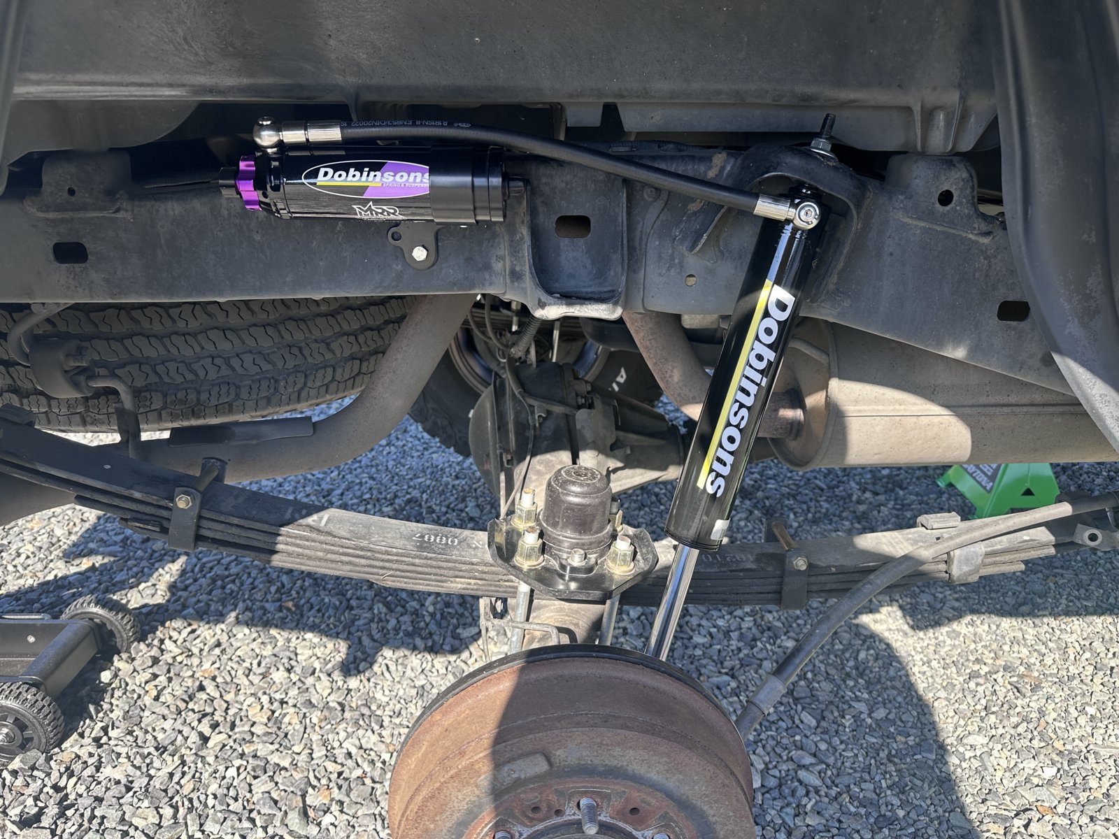

    Installed MRRs front and rear with a leaf pack the end of last year before they raised the prices. Running a 2" lift with stock arms has a tiny bit of bump steer but not bad at all. The ride is like a completely different vehicle. Just be sure to take the time and mount those front hoses correctly.

    I have the Dobinsons adjustable billet UCAs. I specifically went with them because they use the same joints and several other parts as OEM, which will make repairs/maintenance much easier as far as sourcing parts and doing work goes.

    Great post on an interesting topic! Local shop talked me into Dobs MRR over major brands because of the rubber OEM style bushings/mounts and adjustability. Not a well known brand in my area. Went with their lightest coils n leafs on a A/C w shell no other added weight for +2” all around. Ride n handling incredible, tracks straight over rough surfaces. Got 10k on it, super happy!

    Dobinsons tubular and billet arms both use OEM sized ball joints, and they come with Sankei 555 joints installed.
    The bushings are replicas of the OEM size and composition as well. No one else as of right now is making a UCA with rubber bushings and OEM sealed ball joints.

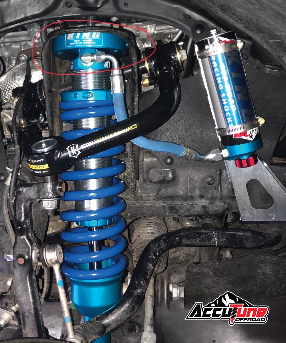

    OP- this kit is similar to the bilstein 5100/6100, “strut with external reservoir (1.5” body)” is the style utilized. The other kits(King/Icon/Locked/ADS. “2.5in body”) are “coil overs with external reservoir”(BEEFY). Major difference in performance/ quality and ride dampening, but most people dont utilize the coil overs to true potential. The only reason i would avoid these “strut style” kits is because they provide little upgrade over stock(besides lift and ext reservoir characteristics, same body size), and i would save some $ for a true coilover(King/Icon/ADS/Locked).
    All options depend on utilization, i went with Kings 2.5 exts to gain some dampening and cooling characteristics(SoCal desert/MTNs based) and have been quite happy with the ride quality overall. Buy it right the first time, and you only cry once. Attached is a photo with the main difference circled in red, the true coil overs mount into a cradle assy, which allows for smooth movements through the entire suspension range. IMO its worth the coin over the others.IMG_0290.jpg

    The issue with Kings/Foxes as someone who works at a shop is I see people come in all the time complaining about the performance they lost after 30k. Which is why I opted for Dobinsons, they provide a significant ride improvement over stock, wide range of adjustment options, and have a long lifetime. The reason why Kings/Foxes have such a short life is because they are made for high speed performance and are meant to be rebuilt. I would love a set of Kings but the lifetime of them does not fit my needs nor lifestyle. I off-road in Colorado so I don’t need a high speed shock rather I need one that has a longer service time. I do appreciate the feedback because it informs people about those minute details like you mentioned which may make a shock out perform others in specific departments. :fistbump:

    Having zero rubber in a coilover (some Fox, Icon, King, etc) to isolate it from the frame is why they blow through heim joints so quickly. It's also likely that the NVH destroys the shock seals as well. Rubber upper mounts and lower bushings definitely give a more comfortable ride under most driving conditions.

    Kings are MEANT to be rebuildable. For a reason, likewise Nitrogen needs to be refilled from time to time. And Kings are tunable as well, not just "high speed" which the oem replacements are "NOT" meant for. The reason Accutune offers a pre-tune before they ship any shock package is that its for your needs.
