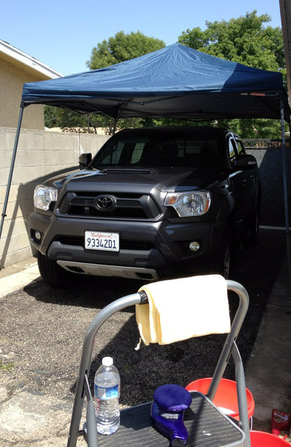

    I use my EZ-Up from front to back, but give each section time to cool off before I hit it with wax. It's a long process, but if helps prevent swirl marks so be it.
