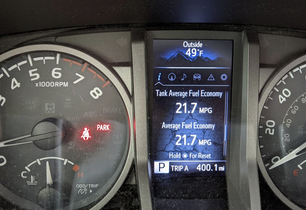

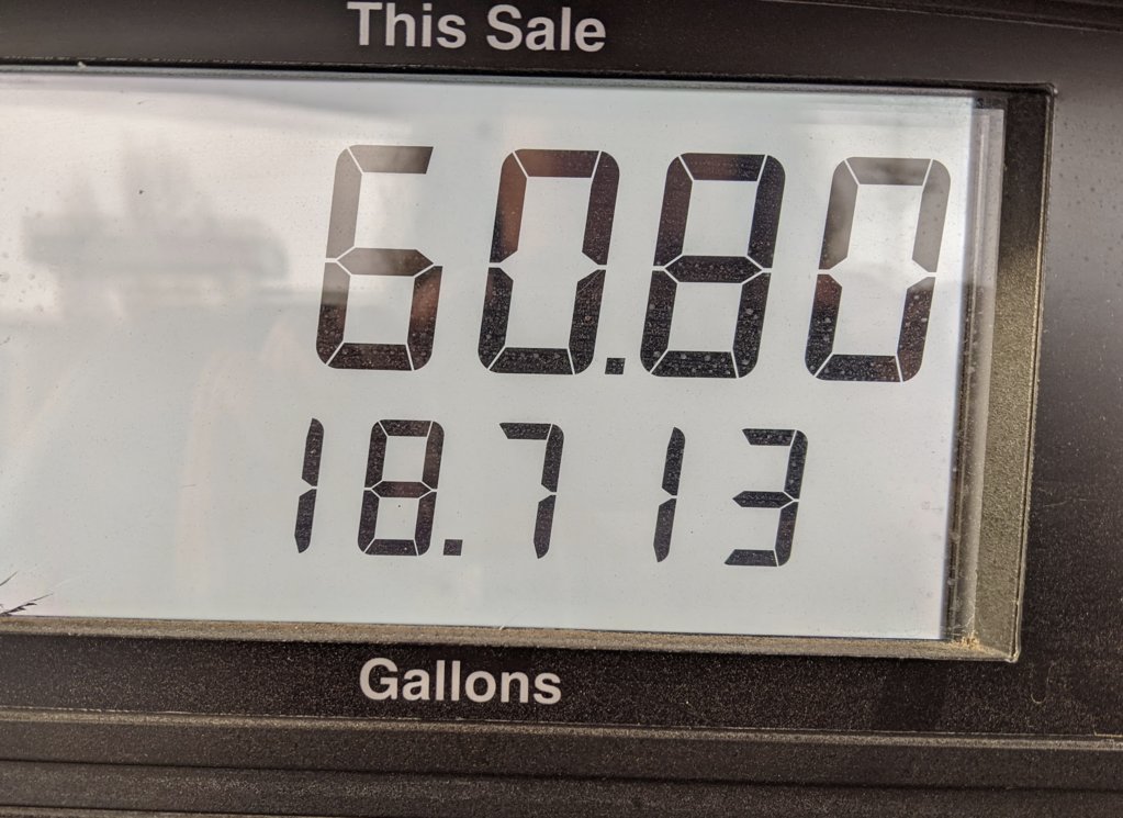

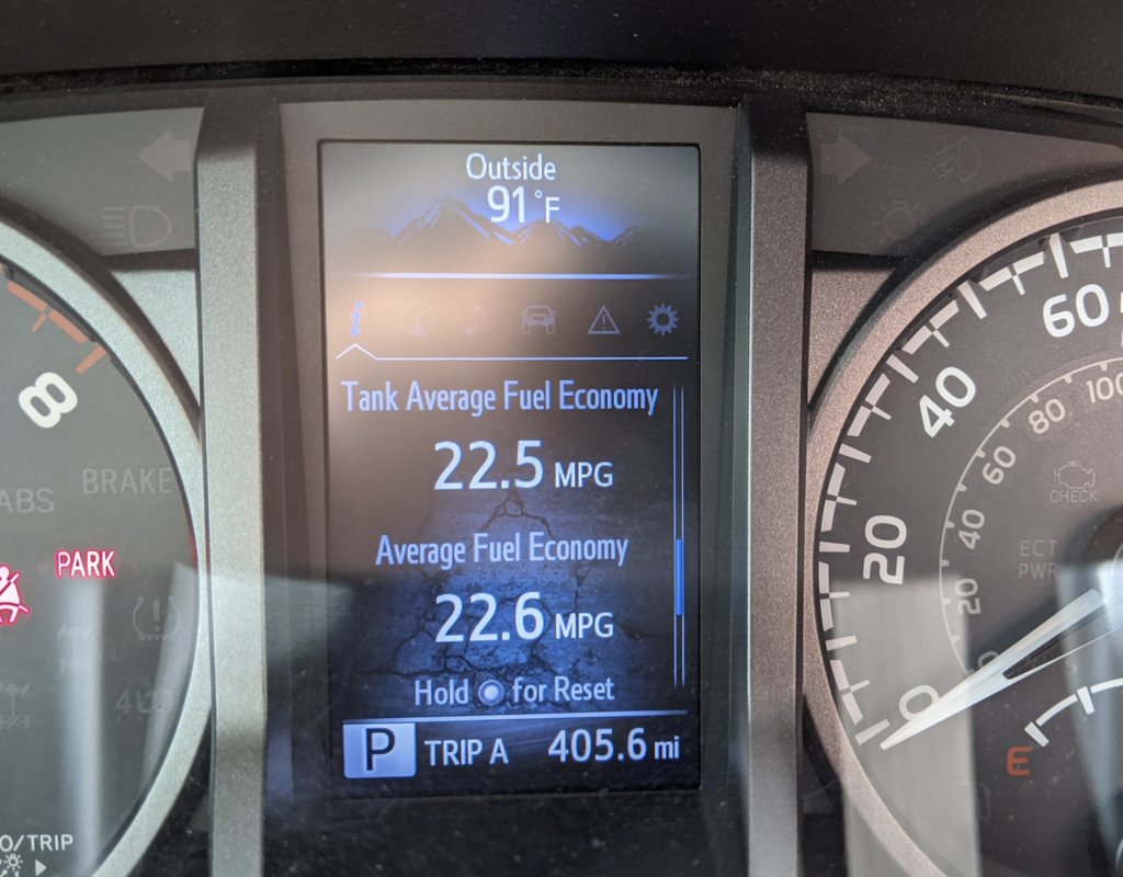

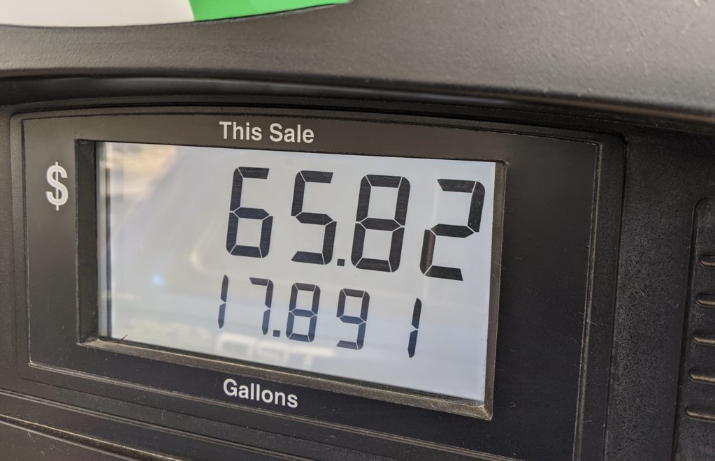

    My MPG measurement was calculated based on miles per tank at fill up. I wish I had archived a few more examples, but here are a couple:
    Winter-ish
    Screen Shot 2024-12-02 at 1.04.41 PM.png Screen Shot 2024-12-02 at 1.05.59 PM.png
    Summer
    Screen Shot 2024-12-02 at 1.16.45 PM.png Screen Shot 2024-12-02 at 1.16.53 PM.png

    Ok so by the fuel economy readout on the dash, not by the odometer and the gallons readout on the pump.
    Many people have suggested that the dash readout is inaccurate. I’ve personally never compared it to anything, because I don’t really care.

    No, by doing the math. 400.1 miles on the first example tank divided by 18.713 gal = 21.38 mpg
    In the second example, 405.6 miles divided by 17.891 gal = 22.67 mpg.
    Those are actually pretty close to the computer's math, but I was doing actual math.
