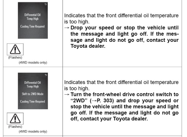

    Where did you read it was removed? From the 2023 owner's manual, page 488, under "Warning message and warning buzzer list": https://assets.sia.toyota.com/publications/en/om-s/OM04047U/pdf/OM04047U.pdf

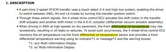

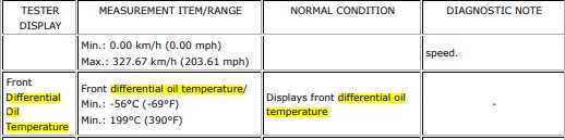

    this is what toyota has to say about front diff temps.
    Sensor range
    Chew and 3JOH22A like this.

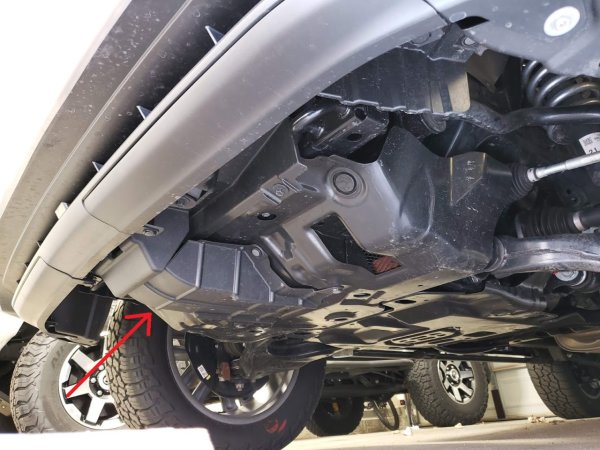

    ^Wonder if that's the reason the 4Runner Limited has a plastic duct on the front skid plate, to direct cooling air to the front diff. The 4Runner Limited is full-time 4WD, so the front diff turns all the time:

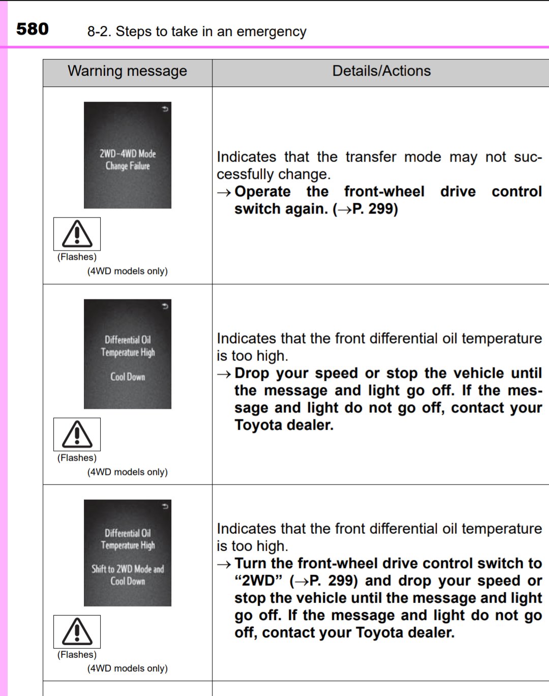

    My understanding is after 2018/2019 the differential housing no longer has the bung for the sensor. When I got my truck regeared I was asked that question. If my info is wrong feel free to correct me.

    While the owner’s manual still has the note about front diff temp warnings, the front diff no longer has a temp sensor. I’m not sure exactly when they got rid of it but I believe it was either starting the 2020 MY.
    I don’t know why they got rid of it, my best guess is they determined the front diff wasn’t something that actually needed any temp monitoring after all.
    As to comparing front and rear and why one had the sensor and the other didn’t, it’s somewhat apples and oranges because you’ve got 2.5-3x the amount of diff fluid back there (keeping the heat spread out through more oil). You’ve also got a larger housing to dissipate heat to and in the OR/Pro/Manuals, you have larger/higher strength rear axle components to take the added brunt anyways.
