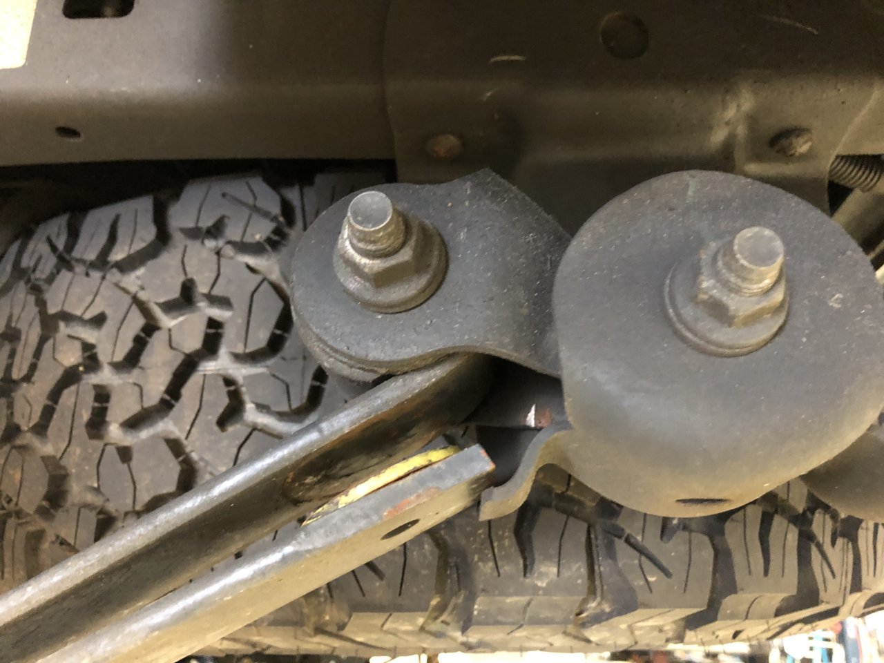

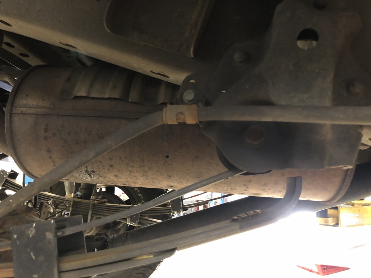

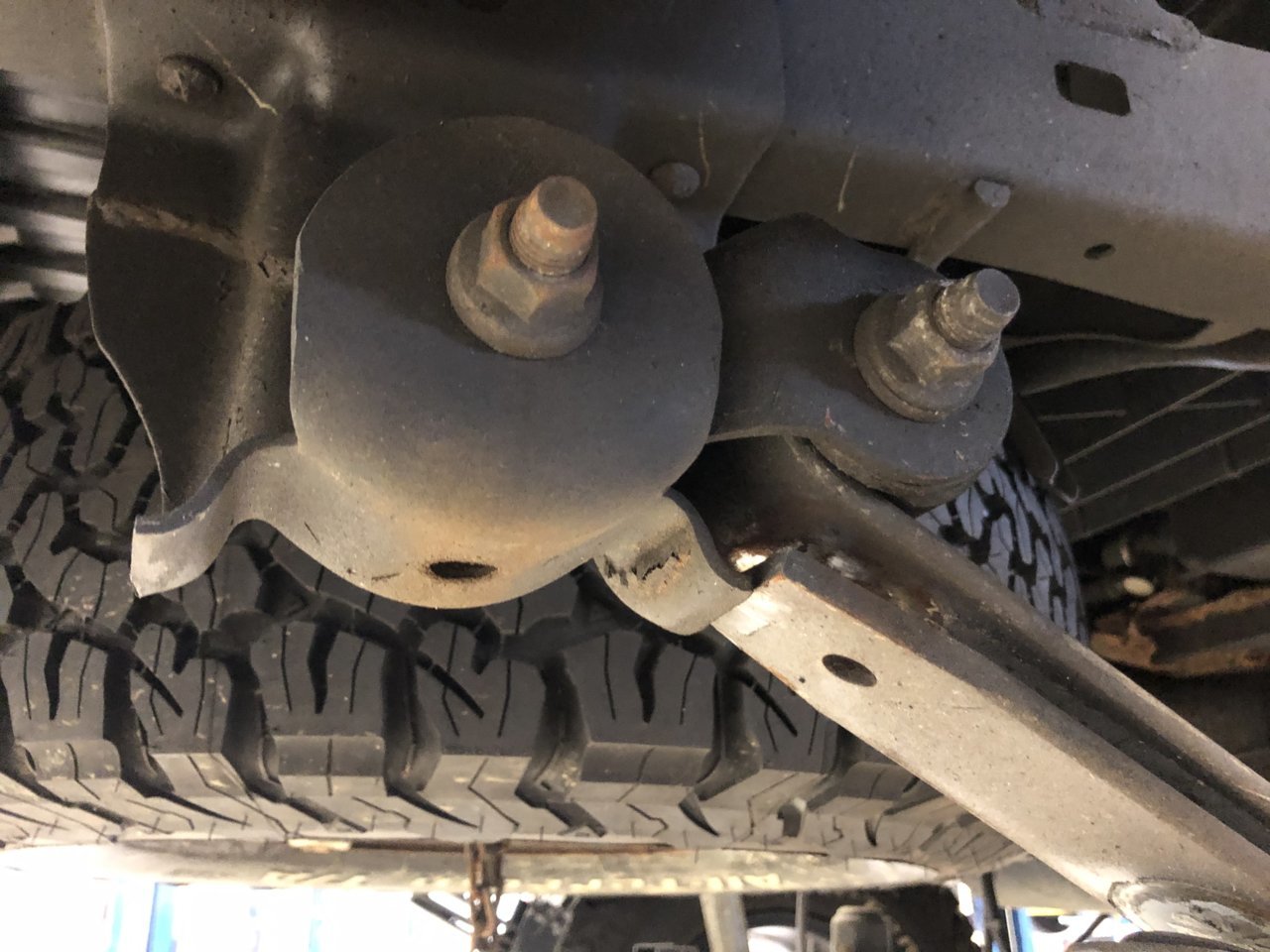

    Every time I have my truck on a lift I question how much droop my axle has. The ABS wires and brake hoses are pulled tight, so are the e-brake cables. The shock boots get pulled off so often that I don't fix them anymore (zip-ties). I took some pictures today while I was under there to better illustrate the issue.
    (the truck is on a lift and the axle is hanging freely)

    yeah they dont exactly look right

    What shocks do you have? I would guess your shocks have more down travel than all those things allow for. This is a reason to run limit straps or different shocks.

    Somethings fucky. you running stock leafs?

    do you have similar pics when it is on the ground?
    Wrong/too short leaf springs? Over-arched spring pulling shackle forward?

    This is the lift I bought. The only thing I added was some bump stops and a u-bolt flip. I got the medium duty leafs and TC upper control arms.

    Those rear shocks are way too long...Have you bottomed out on the bump stop? I ask because the total length of those is 27" and good possibility they are bottoming on the shock. The ones you have look like they are for a 4-6" lift. Go to the link below and click on the different shocks and compare the collapsed and extended lengths.
    https://www.ridefox.com/subhome.php?m=truck&make=Toyota&model=Tacoma+&year=2014&position=Rear
    Here is the King and ICON versions: To add...if you're positive you're not bottoming out on the shock...at a minimum replace your brake lines with extended ones. That way you don't risk a catastrophic mishap if ones of the lines were to break in an off-road situation.
    Here is the wheelers specs the shocks I think you have. Says for a 4" lift with blocks.

    I have extended brake lines (the ones supplied by headstrong). I had to add a spacer to the bracket on the rear axle which helped but I shouldn't have to add anything.

    I don't understand the problem? The leaf is fully extending the shackle at dropped because the shock is allowing it.
    The only issue is if you are going to snap a brake line or ABS wire. If they are super tight I would address that.
    Other then that, it isn't a problem. Just a tension style shackle doing it's thing. If it were a compression style it wouldn't look that bad.

    My issue with what I have is that the extended brake lines, e-brake cables and ABS wires are being stretched. I added a spacer to the bracket for the brake lines, left the ABS wires hanging (near the charcoal canister) and unbolted the e-brake cables near the drums.
