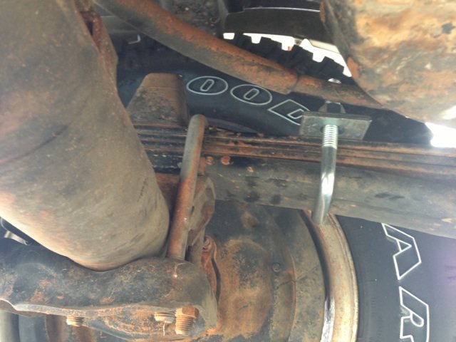

    Taken from that other link you posted.... post #212
    I had mine spaced a little further out than these....

    taco47001...package received in mid-morning mail. don't know how to thank you. gonna install them this evening and take pics...then do a few laps around the neighborhood to test....although it may take more long-term driving to measure true results.
    just to confirm.... i'll be installing them toward the ENDS of the lower-most leaf...correct? so that the lower leaf is flat against the one above it...correct?

    OK...installed the clamps....
    heres the pros and cons:
    PROS...
    axlewrap completely GONE! Huge thanks to taco47001 for the clamps!
    been driving it or 3 days now and no 'bump' at all after braking/stopping/releasing the brakes.
    also, maybe its just me, but it seems like it takes off a little faster when i step on the gas. as if the clamps added a little more torque or something.
    CONS:
    this is a big one....rear suspension is stiff as hell! rides a lot 'harder'. bumps used to be softer. and now they are much harder and the rear end bounces a lot more. almost annoying. I suppose it'll take some getting used to.
    i have a question...would it matter if they were installed with the u-bolt facing downward (with the washers/nuts under the leafs)?

    Im thinking maybe if i slide them in a little..... Toward the middle more.... Maybe i can get some of that soft ride back. Right now i have them just about at the ends of the lower leaf. What do you think?

    UPDATE:
    ok i've moved the clamps more toward the middle of the leafs...about 2 fist widths from the end of the lower leaf. Still no axle wrap (which was my original goal)..and the rear suspension seems to be 'softer' with more cushion. It was just terrible before and I couldn't take it any longer. We'll see how this goes for a while.
