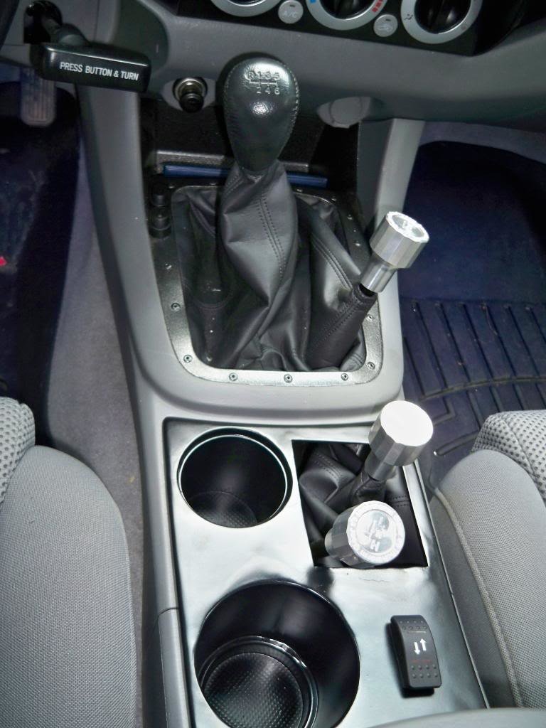

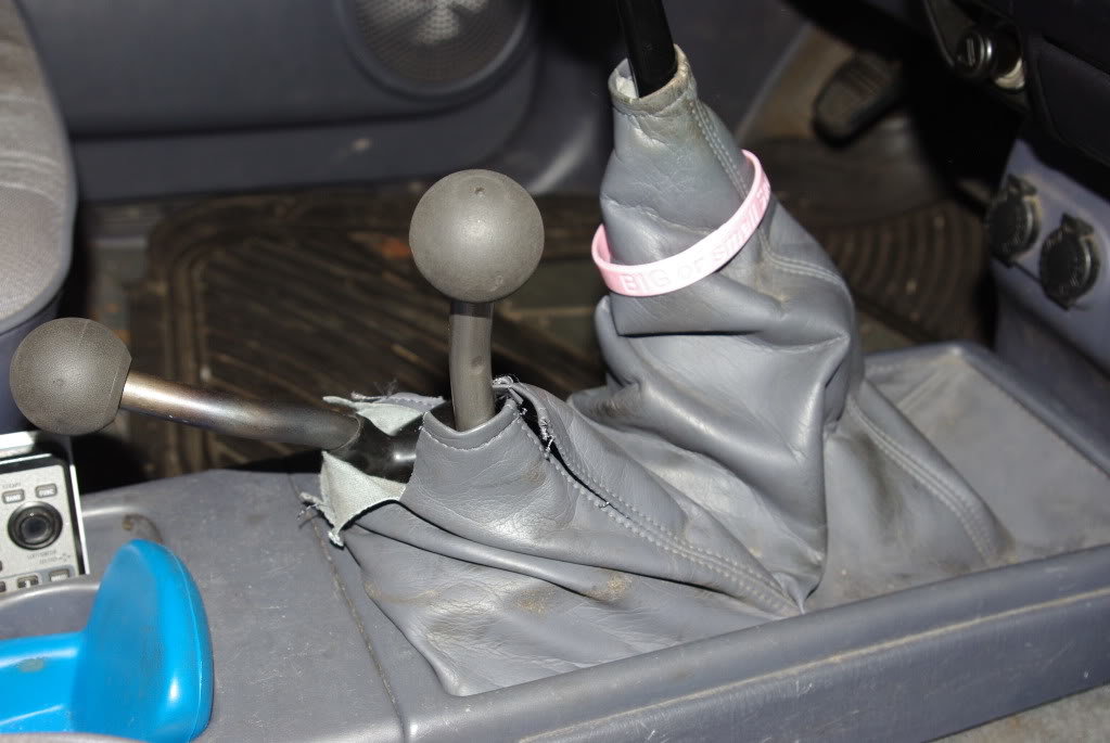

  10. Jan 4, 2010 at 8:37 AM
    #50
    PrezidentRedz
    PrezidentRedz Uncivilized Creations Prez
    Nov 17, 2008
    #10820
    3,688
    Redz
    Owings, MD
    00 Taco 4x4 Xtra Cab, Locked and Lifted.
    Custom Everything! WHAT º¿º
    yeah or you can do this!
  11. Jan 4, 2010 at 8:39 AM
    #51
    98tacoma27
    98tacoma27 is going full "SANDWICH" Moderator
    Dec 18, 2008
    #11714
    67,858
    Ben
    Not Beech Creek
    05 Tundra SR5 (+295k AND COUNTING), 2006 F350 King Ranch 6.0L
    Some stuff. Not a lot, just some.
    Show off! :D
  12. Jan 4, 2010 at 8:54 AM
    #52
    PrezidentRedz
    Nov 17, 2008
    #10820
    3,688
    Redz
    Owings, MD
    haha Sometimes.. but now my truck needs fixin bad!

  14. Jan 4, 2010 at 11:23 AM
    #54
    Fire931
    Fire931 Well-Known Member Vendor
    Jan 18, 2009
    #12687
    3,237
    VA
    00 4Runner
    or you could do this.... :D:D:D
    yea i know its a 2nd gen... but i had to motivate redz to add more shifters!!! :D
    Jon G likes this.
