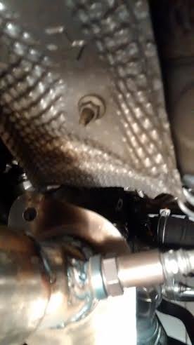

    I've got the Basic 05 Tacoma 4 cylinder automatic with a/c on all the time and it's just a dog around town. It seems it never goes beyond 2,000 rpm there's no real mid range torque. Went into the dealer and found out my rear end differential is 3.58 ring & pinion ratio. So I just installed Doug Thorley Tri-Y headers 2 weeks ago to help in the mid range torque. Their was a considerable difference, and on the highway of course I live in Florida there is no fluctuation on the speed when I had it on cruise control. It is a little noisier when you accelerate. Now looking for my options as to get rid of some of the noise, but overall I'm happy with the added performance. Update 2/4/16 the aftermarket header flange was misaligned and leaking exhaust gasses. So I had a muffler shop weld a pipe directly to it. Problem of noise fix, warranty of header voided due to altering header.
