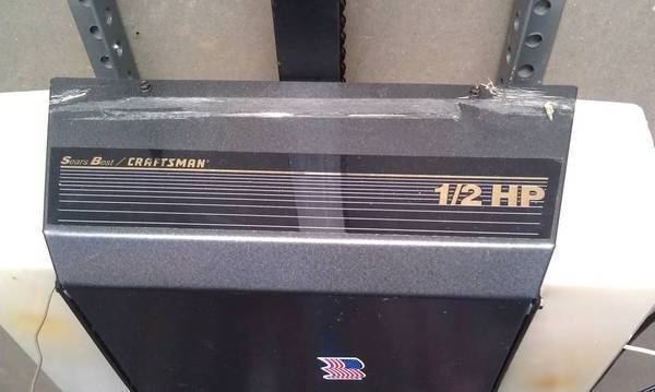

    So recently my garage door opener has started to open the door all on its own. I guess it started about a month ago. I've been unplugging it at night now. So far it hasn't happened when I'm not at home. As far as I know anyway. Also its only ever opened by itself. I left it sit open one day seeing if it would close, but nope. Anyway I'm assuming its the main button.
    Ignore the tape residue, DB owner before had it on there cause he couldn't figure out how to properly put back on the light covers.

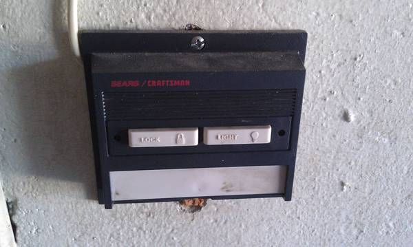

    I'm 98% sure its not another similar remote or mine malfunctioning cause if you look at that main control, it has that lock button. When that is pushed it locks out the use of remotes. It will only open when the lock is engaged with the main button.

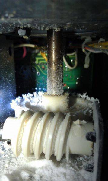

    Only work I've had to do to it almost a year ago today was change the drive gears after this happened...
    Other than that, and now this, its been working fine.
    I'm asking because maybe someone has had this happen to them and maybe its something other than the main button. I figure if no one knows I'll start easy by replacing that button. Other than that I wouldn't have a clue where to go from there or if its even worth it.
    Thanks in advance for anyone's help.

    Replace the batteries in the remote in your truck. The button on the wall should just be connected via a n/c or n/o contact at the unit. If it only happens when you're home my first thought would be the one in the truck. Or aliens.
    Also I have never been able to use the lock button. Doesn't seem to work properly.

    If the switch is old it could be the contacts inside the switch are arcing. Replace the switch or pull it apart and clean/check contacts. If replacing switch there should be a serial # that you'll need to order the switch, behind one of the light shades. I use to work for Sears Parts and people couldn't find the serial #.

    Late reply, but yeah I'm not paying anyone to come out. I'll replace the button myself and go from there. I hate to put in a whole new opener in when besides this, works fine. House is gonna be up for sale again soon, so I want it working properly. If not I'll tell the potential buyer and knock a couple hundred off for their troubles.

    It's remaining unplugged until I can get around to changing out that main control. Look pretty inexpensive so that's my start.
