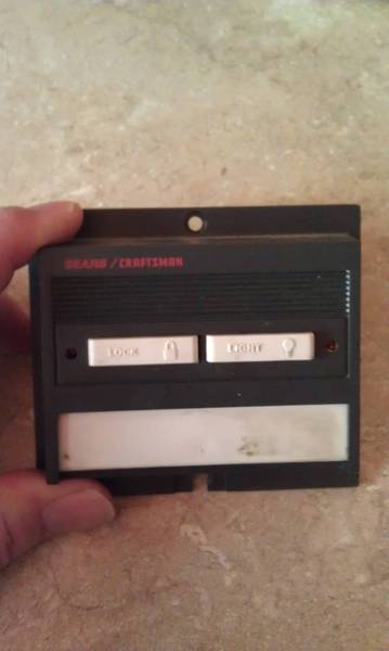

    Finally got around to taking this off.
    Going to stop at Sears today to see if I can get a replacement. I did take it all apart and didn't notice anything wrong that looks like it would be bad. Who knows.
    It's currently plugged in so if it goes up without the main control then I would know its not that too.

    Just as a heads up for anyone with this issue or broken main control etc... If it has the four wires attached to the back rather than just the two like all the newer models, then you probably won't find a new one. Only ones I could find where used on eBay. Didn't want used to just end up with the same issue. Checked Sears and they only had a $20 one but only the two wire version. So got a $5 lighted door bell and works just as good. Plus the light is brighter for nighttime use. Just don't have the separate light control or lock now. Oh well. I'll live.

    It was the main control button, gone bad. All is well now. :thumbsup:

    Check the main control button , they can go bad
