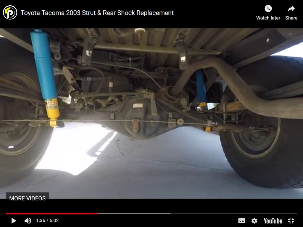

    hartterc
    hartterc Member
    Aug 8, 2019
    #301642
    15
    Shasta Lake, California
    2003 TRD Tacoma 4x4.
    none
    What mine looked like when I replaced them. Boot on top. My Rancho's are the same way.

    Kwikvette
    Feb 27, 2019
    #284735
    81,415
    Fresno County
    4 run, 2 don't
    Those are 4600s, not 5100s
    LoveableWerewolf likes this.

    hartterc
    hartterc Member
    Aug 8, 2019
    #301642
    15
    none
    I'm using the photo as a reference how they looked when I replaced the original bilstein shocks that were on the truck when I bought the truck new in 03.

    Kwikvette
    Feb 27, 2019
    #284735
    81,415
    Fresno County
    4 run, 2 don't
    Bilstein 4600s are installed the way in which you described.
    Bilstein 5100s however, are the shock in question; those are installed in the opposite manner than you describe.
    This is from Bilsteins own literature when you purchase their 5100s.
