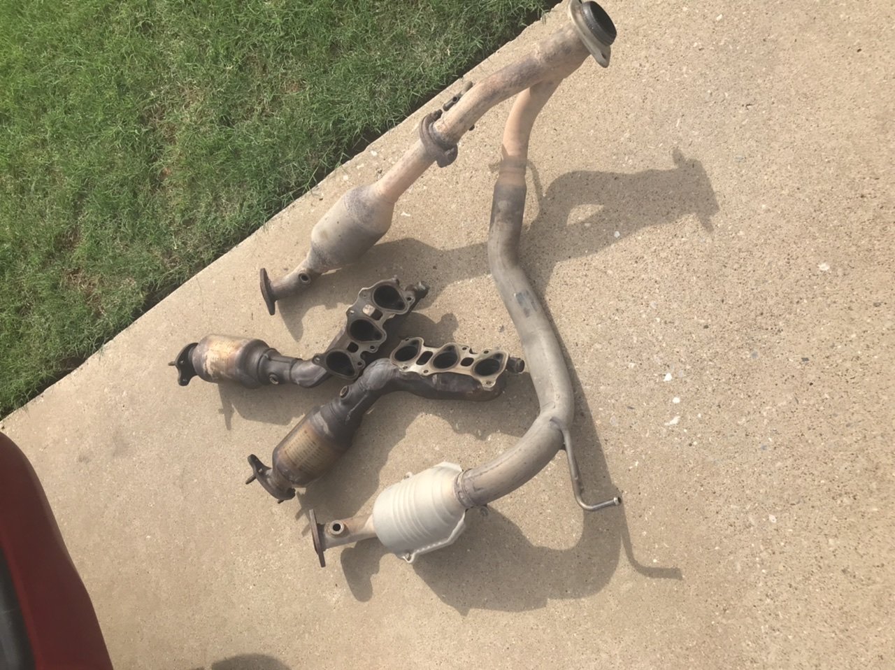

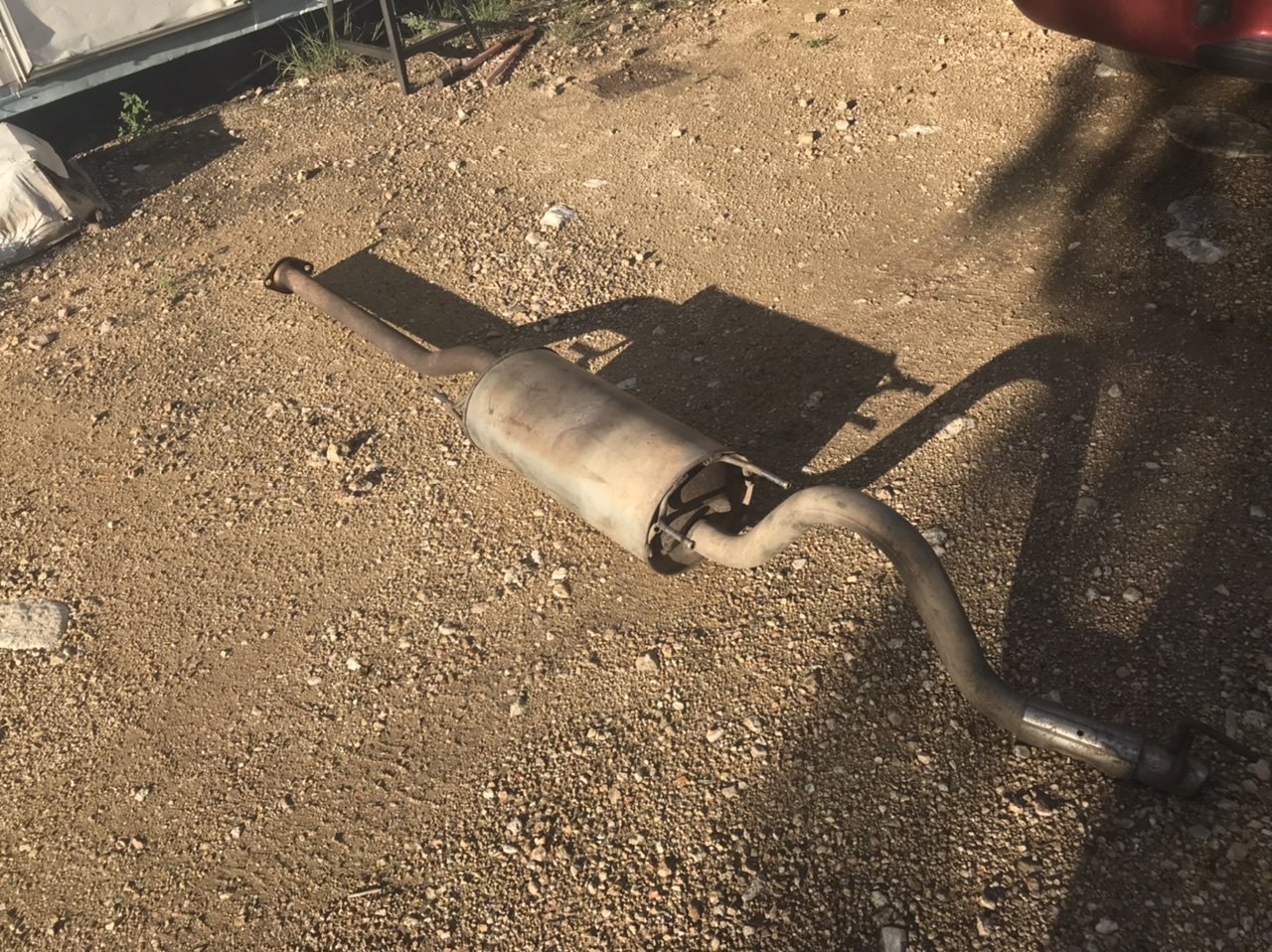

    Here's what the stock catback looks like, big ol muffler
    here's a pic of the stock manifolds and y-pipe, also would be good to check these. If the PO put long tube headers that are catless, or a catless ypipe, this would make it louder too
